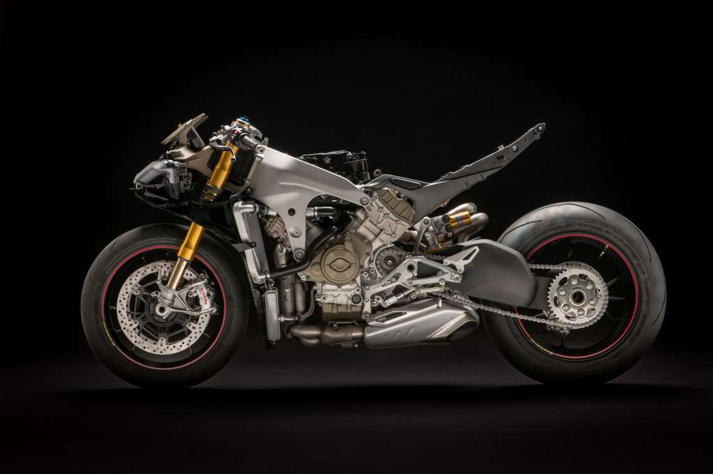

The philosophy followed by the Panigale V4 development team mirrors the approach taken by Ducati when developing a racing bike: total integration of engine, chassis and rider. To achieve that goal MotoGP-derived technology has been employed. Development has involved Ducati Corse technicians and riders, making the Panigale V4 a production sports bike that comes close to being a MotoGP prototype, built for both excellent on-track performance and outstanding on-road ridability.
The Desmosedici Stradale engine is a 90° V4 with Desmodromic timing, just like the Desmosedici GP from which it also takes an 81 mm bore (the maximum allowed by MotoGP rules). This has been combined with a longer stroke than that used in racing (giving a total displacement of 1,103 cm³) to boost low-to-mid rev torque and reduce maximum revs so that the power is easier to handle. The new Ducati engine puts out a maximum of 214 hp at 13,000 rpm, making the Panigale V4 the most powerful bike in the segment, yet easy to handle thanks to a torque of 12.6 Kgm at 10,000 rpm. Despite such outstanding performance, the Desmosedici Stradale has long maintenance intervals, with valve clearance inspection only necessary every 24,000 km.
The Panigale V4 engine is the only one in the sports segment with a 90° V configuration. It’s also the only engine to use technology such as the counter-rotating crankshaft and twin pulse ignition. These solutions have a positive impact on bike dynamics, making it more agile during changes of direction, fast and stable on the straight and ensuring easier out-of-the-corner torque handling.
The already high power of the standard Desmosedici Stradale configuration can be boosted to 226 hp by mounting the all-titanium racing exhaust, made by Akrapovič as per Ducati Corse specifications.
To contain the inevitable weight gain with respect to the 1299 Panigale (because of the 4 cylinders) Ducati has developed an all-new frame where the Desmosedici Stradale itself has a load-bearing function. Called Front Frame, it’s more compact and lighter than a perimeter frame and uses the engine as a stressed chassis element. This solution ensures the right torsional rigidity for on-the-edge riding and gives riders outstanding “feel”. The Front Frame has allowed the designer to create a bike that is slender in the tank-seat merge zone: this, together with seat/handlebar/footpeg triangulation, ensures perfect bike-rider integration. Together with meticulous design and the use of light materials, the new frame keeps the kerb weight of the S and Special versions down to 195 kg. This weight, combined with the 214 hp, means a power/weight ratio of 1.1 hp/kg, putting the Panigale V4 S at the top of the sport bike segment.

o New Desmosedici Stradale engine, 1,103 cm3
o New “Front Frame”
o Cast Magnesium alloy front sub frame
o 43 mm Showa Big Piston Forks (BPF), fully adjustable
o Sachs monoshock, fully adjustable
o Sachs steering damper
o Latest-generation electronic package with 6-axis Inertial Measurement Unit (6D IMU): ABS Cornering Bosch EVO; Ducati Traction Control EVO (DTC EVO); Ducati Slide Control (DSC); Ducati Wheelie Control EVO (DWC EVO); Ducati Power Launch (DPL); Ducati Quick Shift up/down EVO (DQS EVO); Engine Brake Control EVO (EBC EVO)

Engine Desmosedici Stradale 90° V4, rearward-rotating crankshaft, 4 Desmodromically actuated valves per cylinder, liquid cooled
Displacement 1,103 cc
Bore X stroke 81 x 53.5 mm
Compression ratio 14.0:1
Power 157.5 kW (214 hp) @ 13,000 rpm
Torque 124.0 Nm (91.5 lb-ft) @ 10,000 rpm
Fuel injection Electronic fuel injection system. Twin injectors per cylinder. Full ride-by-wire elliptical throttle bodies. Variable length intake system
Exhaust 4-2-1-2 system, with 2 catalytic converters and 2 lambda probes
Gearbox 6 speed with Ducati Quick Shift (DQS) up/down EVO
Primary drive Straight cut gears; Ratio 1.80:1
Ratio 1=38/14 2=36/17 3=33/19 4=32/21 5=30/22 6=30/24
Final drive Chain; Front sprocket 16; Rear sprocket 41
Clutch Hydraulically controlled slipper and self-servo wet multiplate clutch
Frame Aluminum alloy “Front Frame”
Front suspension Fully adjustable Showa BPF fork. 43 mm chromed inner tubes
Front wheel 5-spokes light alloy 3.50″ x 17″
Front tyre Pirelli Diablo Supercorsa SP 120/70 ZR17
Rear Suspension Fully adjustable Sachs unit. Aluminum single-sided swingarm
