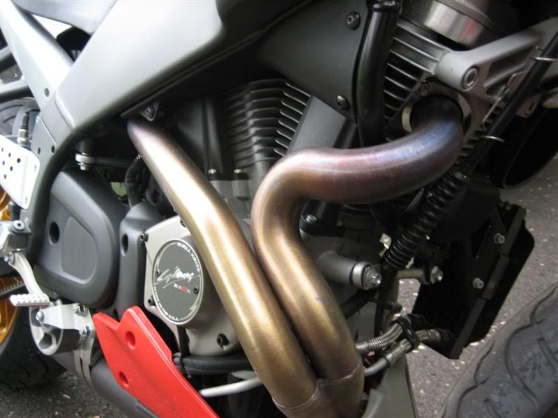

earwig
Posts: 984
Joined: Thu May 19, 2005 2:11 pm
Location: New Jersey
#20 Unread post by earwig »
My bike's blueing pipes :)
