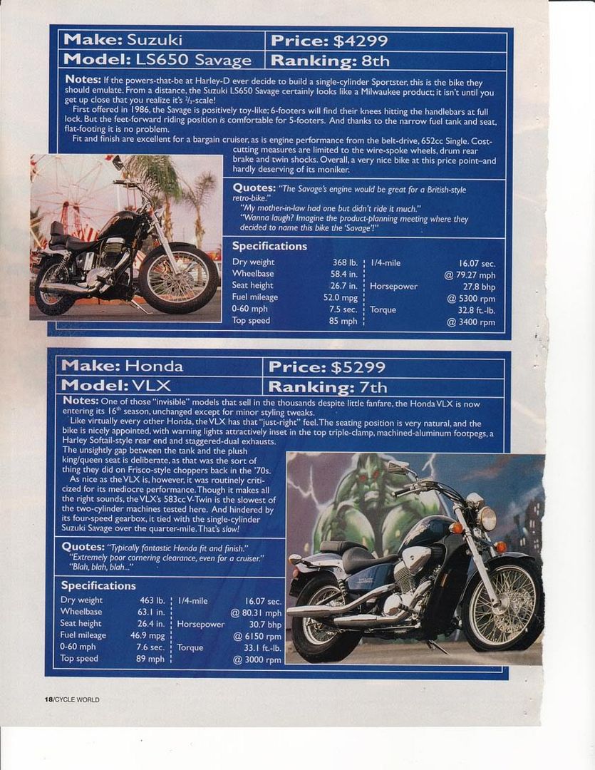

Here's a more recent figure from Cycle World showing even less hp for a VLX:
http://img.photobucket.com/albums/v443/ ... deals3.jpg
These are real world hp figures of rear wheel hp as measured on a dyno. If tou take the same bike to 3 different dynos on the same day you will get 3 different figures.
For years the hp of the GS500 for example has been measured at about 40 hp as reported in published road tests by the moto mags but the Suzuki UK site always reported about 50 hp. I suspect the 50 hp is measured at the crank and not at the rear wheel or maybe they use a different breed of horses in the UK.
