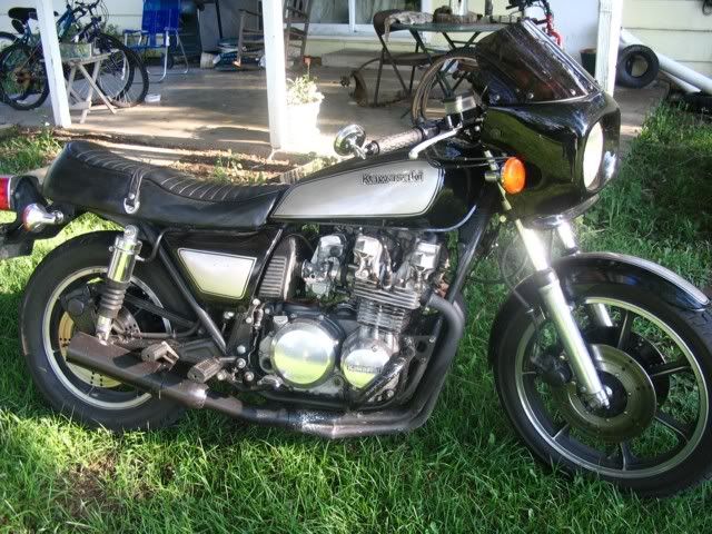

Wow! Thanks for all the replies guys. And thanks for the compliments. Zoo, It's a little of both on the condition. The first owner was a machinist, and I think he had it painted this paint scheme (not original color, but similar to spectre). He probably put the air shocks on and moified the forks to air charged. I have since put the forks back to stock with no air, but 20 weight oil. The second owner was a farmer who had it for the kids and grandkids to ride, I guess. The guy I bought it from was going to do something "special", but ran out of money after just riding it a couple times a week for a year and a half. It was a little rough when I got it, but ran fair. Needed battery, tires, plugs, basic tune-up stuff, like carb synch (this was way off), and timing (also off). Now it wheelies in second and can lift it in third as well (just a few inches). It's possible the first owner did other things internally that don't show, being a machinist...who knows.
I put the faring on, sculpted the seat a little (SR model seat pan is totally different than other models of kz), put blue halogen bulb in, Lots of cleaning and polishing (especially all the engine covers). I've put nearly 10,000 miles on since last September, when I put it on the road. It's really a sweet bike...looks beefy, and low due to all the black on it, and the 16 inch wheel in back. As for the question about the back end, I've toyed with the idea of a kz650 tailpiece, but the frames are different. I could still do it, but I think i might fab a new mount for the taillight, and move it up behind the seat then chop the fender to expose the tire a little.Thanks again for all the great inputs. I really appreciate it.

Joe, there is a great site for anything you could possibly need help with. It's KZRIDER.com. I didn't even know that when I bought my bike. Chris and I were talking last night, and we concluded we can't think of a better all-around bike for me than this one. I just change it around if I want to liven things up a little. Budget was a big player for me to re-enter riding, and I paid $895 for it on ebay. I have replaced all the cables (or will have in a couple days), the items noted above, and added the faring. I like to wrench, but this bike hasn't needed much of that. I did modify my cam chain tensioner, and will replace the cam chain when my added slack adjustment runs out. This is a common gremlin on some of the "newr" kz's, and I can tell you how to fix it if you get one.Joe Mc wrote:The bike looks excellent Ron. I'm considering a KZ650 for my next bike. It's suppose to be one of the better UJM from what I have read.

Here are the drag bars, with my fabricated bar-end mirrors. I got two 3 inch custom Harley mirrors, two 3 1/2 inch x m6 bolts, two scrap 3/8 inch X 1 inch grade eight bolts, and welded the 3/8 bolt to the long metric bolt. I used this to extend the bar-end weights I already was using, by putting an old 1/2 inch socket between the weight and the rubber plug. The harley mirrors use a set screw that tightens on the 3/8 bolt. These mirrors are very clear and vibrate far less than the long ones I used to use. The whole thing looks pretty good even without paint, which will have to wait a few days.
