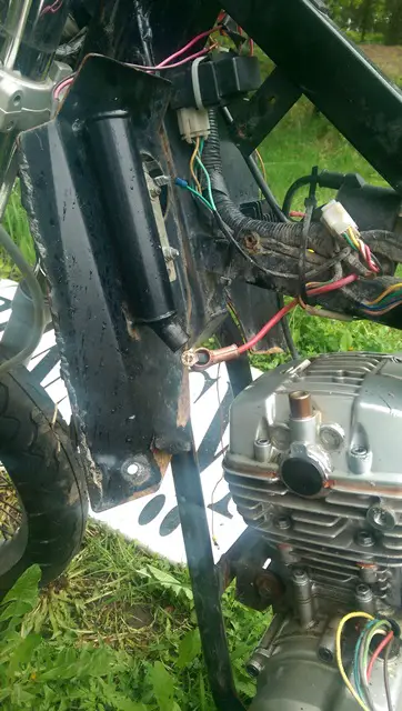

There is also some sort of long but thin, cylinder shaped, metal object on the front plates next to the frame of the bike.
The object has 1 nozzle at the bottom pointing towards the engine and is otherwise sealed.
I was thinking if someone here knows if this has something to do with the pipe sticking from the engine since they both are located on the same side of the bike and the cylinder shaped object hasn't had any use until now and i still dont know what its supposed to be.
Diameters of the cylinder is ~15cm long and ~2,5cm wide
Oh and the bike is a Supermotard, and what i mean by the front plates is the place where the radiator is typically found on supermotards/enduros, between exhaust and gas tank.

Okay so, I went and got a picture of it. Hopefully this will clear something up. There are all 3, the cylinder shaped object, the pipe on the valve cover and the black piece of plastic right under it. The red wire is the solenoid wire, so that wont cause any confusion

This is an air-cooled engine, right? So I'm not seeing radiator mounting holes or a coolant expansion tank?
If it's air-cooled and has always been air-cooled and the frame is original for an air-cooled engine then my guess is that the engine pipe is the crankcase breather and the cylinder on the frame is some kind of expansion chamber volume connected to the crankcase breather. But I've never seen an arrangement like that and am only speculating.
What is on the top of the black cylinder? Is it closed or open?

Yes, this is the original air cooled engine and the frame is non-modified and meant for this exact engine.
So no coolant pipes, radiator holder etc.
The backup engine that was on this bike was also air cooled, but it didnt have any pipes on the top of the valve cover.
The cylinder is fully sealed from top and around, except for that little nozzle that comes from it at the bottom.
I have this problem of buying, bikes or cars that are more unique and you dont see everyday on the road, and it always takes a toll when i need to repair the engine, since there are no parts or instructions available anywhere.
So i'm pretty much open for any suggestion what these parts might be.
I was thinking here, this is totally something that i have no idea of and was just wondering, if the engine blows air from the pipe to the black cylinder trapping the air, and creating sort of backpressure for the engine making the compression better, or reducing blow by air ? this is probably all very funny sounding, but i mean it could right ?
