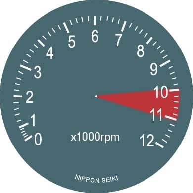

First off here is the tach redesigned. The numbers seem very large compaired to the other, but the thing is, for this one, I took a picture of the original and used it like a tracing guide to redraw it. So the size of the numbers is more accurate, but I'm still contimplating shrinking them slightly.

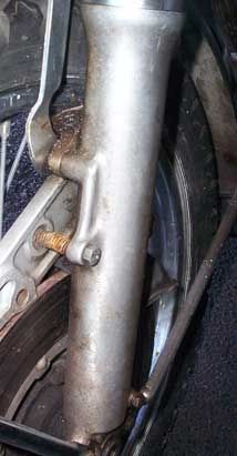

Here is the right side fork. Uncleaned and unpolished. As you can see, very dirty and ugly.

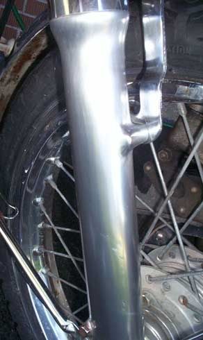

And here is the nice clean left side fork. Looks great except for the scratches that are too deep to remove. I'm still very impressed how well it cleaned up.

Unless your going for a full factory restoration, your forkleg is bitchin'. Do up the other one and your homefree. Looks good.... now you got to keep polishing it forever to keep it from turning furry.... :twisted: :mrgreen:

BuzZz wrote:Unless your going for a full factory restoration, your forkleg is bitchin'. Do up the other one and your homefree. Looks good.... now you got to keep polishing it forever to keep it from turning furry.... :twisted: :mrgreen:
A good use for Nevr-dul (not sure of spelling). Once it looks like that, the stuff works great for quick cleanoffs.
