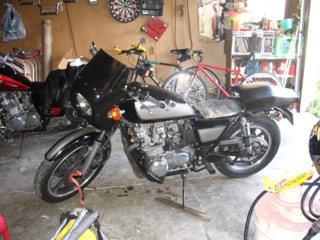

Here's the mockup in black primer. This is the final shape and size. The rest is finish work, although the black shows the need for some minor smoothing first.
Ride safe...God bless!
-Ron

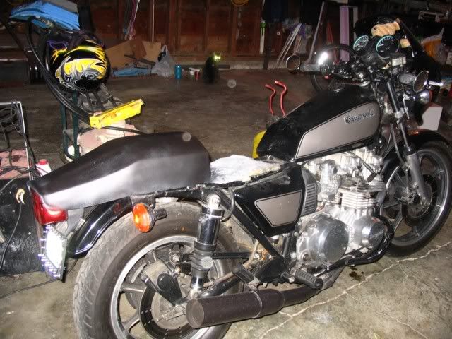

Thanks guys! Just in time for the cost of fiberglass to skyrocket, too. Finished the glass work just in the nick of time. After that photo, I sanded, spot puttied, sanded and primed again. It's looking like the sanding on this primer coat may be it! Once it's painted, I have to wait a couple of days, because of all the handling it will get building the seat. I even have to turn it upside down. I'm considering building the seat, then masking it and painting...almost talked myself into it...we'll see. This pic shows the detail in the tail better. It's dark here, and flash pictures glare..sorry. I'll get some good ones for the seat building..it will be light out.
-Ron
