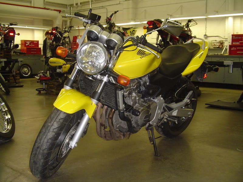

In other news the last time I took the bike out for a ride was before I replaced the sprockets and chain. I was experiencing some problems with the back end feeling like it was slipping around during initial cornering. It would slip a bit, then stiffen up and catch. Very disconcerting.
Since then, I have replaced the chain and sprockets as said above, and :oops: inflated my tires to recomended pressure. What a difference! The back is rock solid...
And my problems have migrated to the front. I'm experiencing headshake during.... spirited cornering. Actually, my left mirror managed to shake itself loose as I exited dunvegan valley. I'm hoping that it might just be the cold coupled with some hesitant (tight gripped) riding... anyways, I spun it back into position, but I'll need to tear apart the front end now. LoL. Fortunately the worksheets for the rest of the week are service head and swing arm bearings. Deliciously ironic.

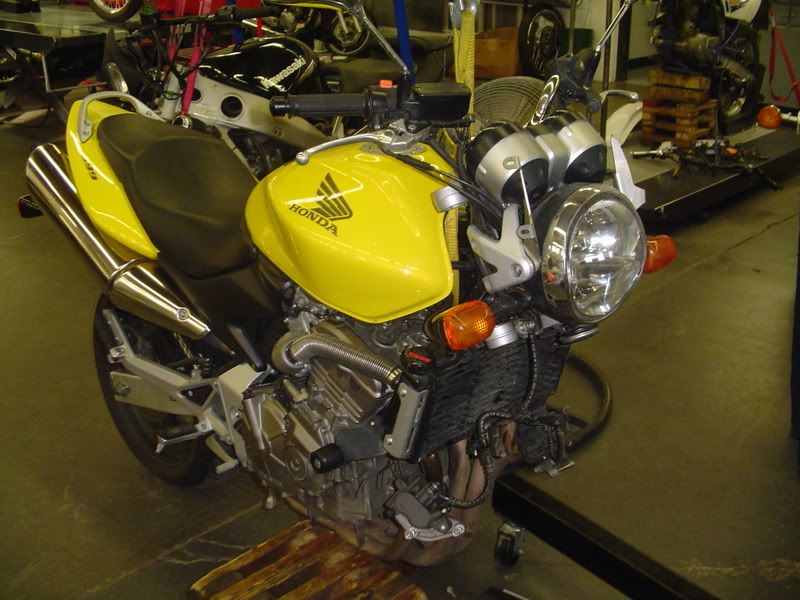

No man should ever have to see his bike like this.
Front end totally ripped apart

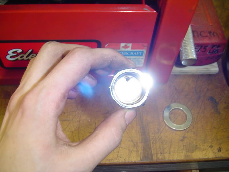

Somehow a small bug managed to work it's way UNDER the steering head cap, a nut that is installed at factory, has never been removed, and is placed at 76lb/ft of torque
Goodbye forks, they weren't good for much anyways... sigh

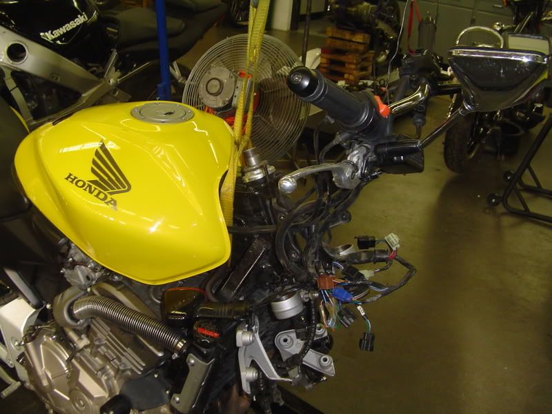

Notice the brake calipers are suspended from wire instead of the brake lines. This is the correct way to do it.

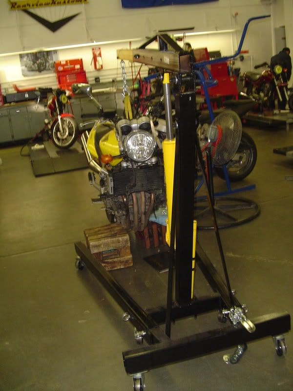

Okay, so all of this because I've been feeling some headshake while cornering. I spent the whole morning pulling my bike apart, every time I thought I'd disconnected everything, there was one more thing to be undone ;(. I got my bearings out, but ran out of time in the shop today to inspect them. However at first glance they appear okay.
This means the headshake is coming from somewhere else.
I did notice something though, my handlebars (which have never been removed from PDI that I can tell) were set 1/4 inch to the right inside the mounts. YIKES, no wonder my left arm always seems to hurt, it pulls my left arm to far to the right. Little things, little things, watch the details!
In the first and fourth pic you can see my friend Josh's bike. He's building a stunt bike out of a ninja 600 with an R6 subframe/seat set mounted to the back. He's replacing his bearings right now.
In the background of the second picture there are two Honda CG125's. These bikes belong to the Alberta Safety Council. The Edmonton version of the MSF... what does that mean? NAIT does all the maintenance for the bikes that some of my friends use to teach people to ride... And they abuse the dodo out of those bikes!

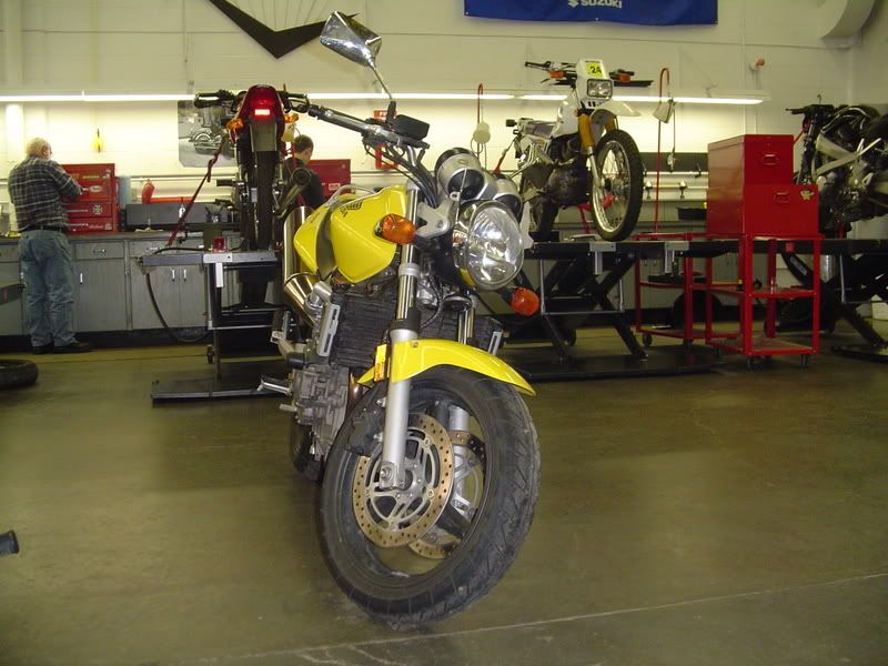

Okay, here's my bike all slung up from behind. Everything is fully dissasembled, and greased up. Ready for reassembly.
You can see sitting next to it a Bandit 1200(2004), and an M109R(2006). Behind the bandit is a Busa 1300(2006). These are some of the bikes we get to work on. And any bike that we work on we get to ride on the dyno... except the M109R it's rear tire is to big.
I didn't have the time to take pics during reassembly as I've got to be ready to pull the swing arm apart tomorrow. It's kind of neat to know that I now know how to pull the whole front end apart. I should have replaced my fork oil while I had to forks out, but I just didn't have the will to do so. I'll be doing that over next summer.
