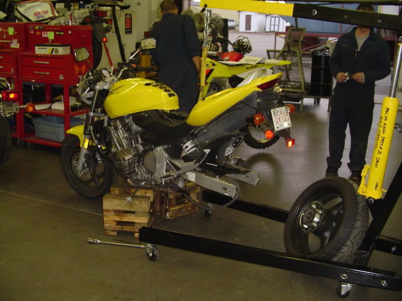

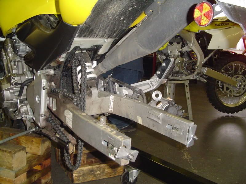

Picture this, you just spent 6 hours pulling apart the entire front end of your bike. Right down to the steering head so you could grease the bearings. What do you do next?
You pull apart the swingarm.
Remove the rear tire, brake assembly, hugger/chain guard.
Then removed the lower shock bolt and finally the swing arm pivot bolt.
You will note two things in this picture: 1) The rear brake caliper is removed from the swing arm and once again suspended using mechanics wire. There is also a piece of cardboard wedged in between the brake pads so that the bads will not wedge firmly together (requiring I pull apart the entire brake system to unwedge them) if someone accidently presses the rear brake lever. 2) The chain is tied to the subframe to keep it from getting rubbed around in the dirt while I'm working on the bike.
Clean all the parts... then reassemble 3 weeks later because you're now doing electrical. ARGH!!!! :evil:

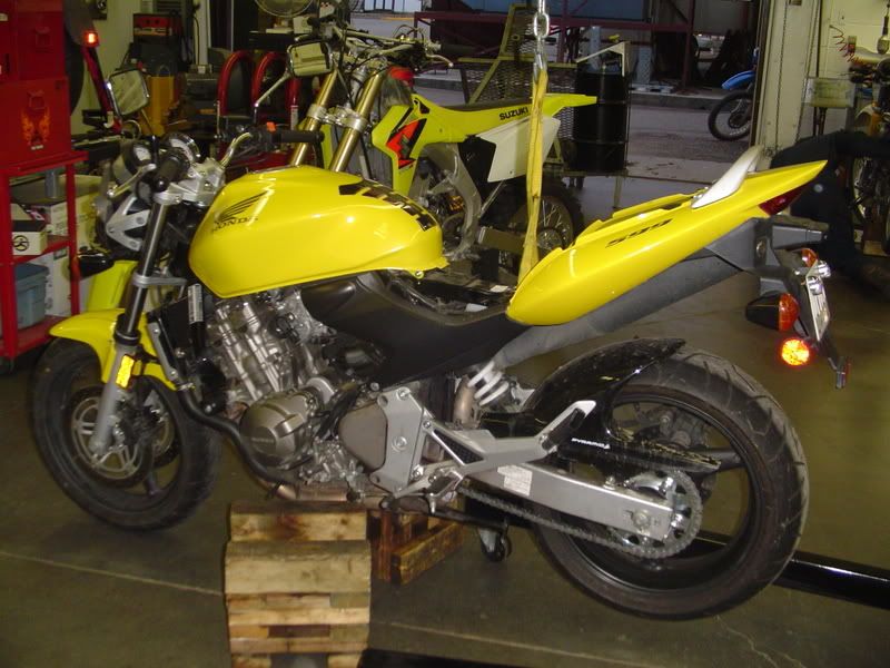

I snuck into the shop. We're not supposed to be in there without an instructor present... liability issues or something. And snapped a couple of quick shots of my bike dissasembled and cleaned... sorta.
This is what a 599 with no swingarm looks like.
This is the cleaned parts.
I'm reposting this picture to give you an idea of just how dirty it was before.
This is from when I installed my hugger... at the start of the season. It hadn't been cleaned between then and now.
Suffice to say it was pretty gross, lots of built up rocks and all kinds of chain lube. I spent a lot of time in there with kerosine and a brush+towels. It was a lot of work, but looks almost new now. So it was worth it.
