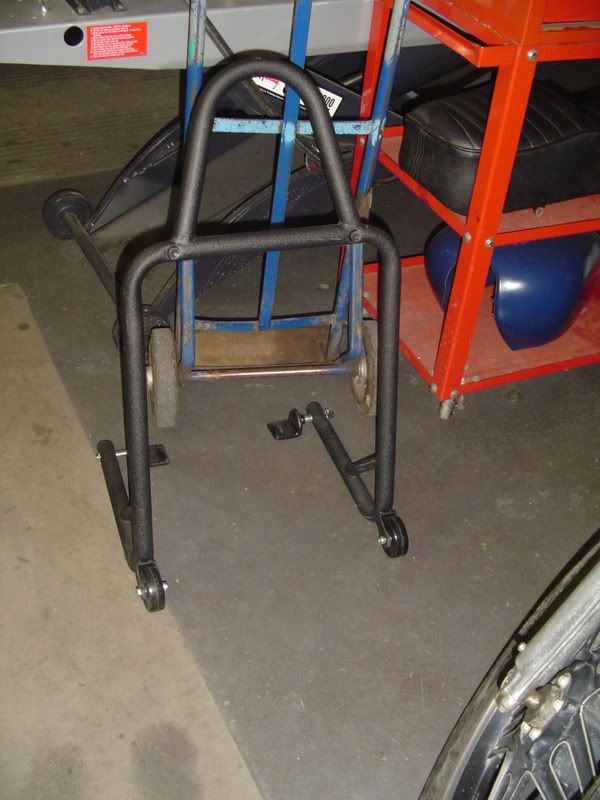

Skier, sorry it took so long to get back to you about the stands. I bought this one and brought it with me to class. Just a basic paddock stand with paddle lifters. It cost me $80 Canadian. You can get a bobbin type one, but that involves drilling holes into the swing arm, then countersinking them to make sure that the weight of the bike doesn't tear the bobbins out of the soft aluminum. Yikes! Not a cheap mistake.

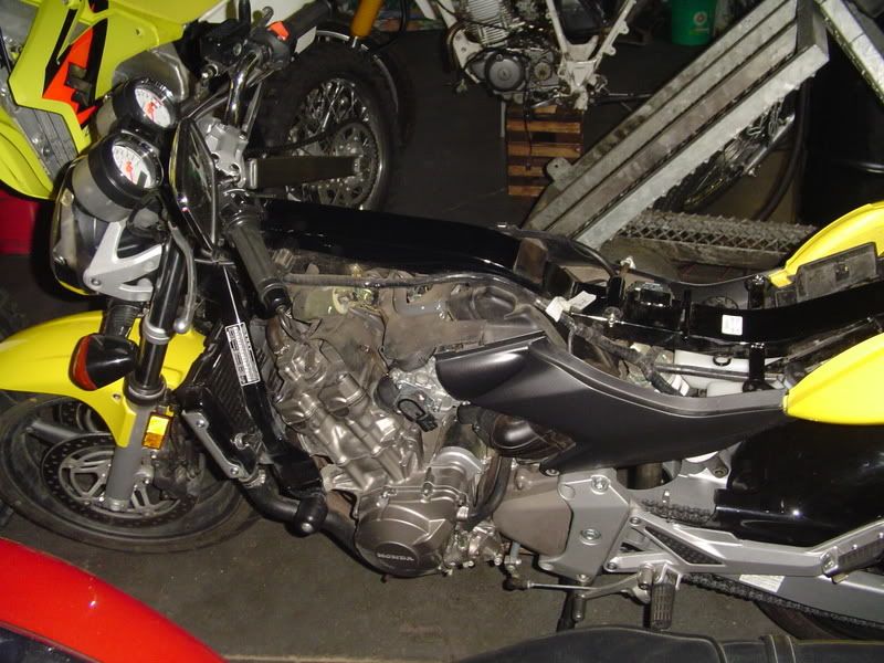

As for my bike? Now that I have the swing arm back together I start pulling apart other stuff. Pulled the tank off and removed the petcock, found a lot of "precorrosion" and some spot rust on the inside of the tank, plus a bunch had caught in and around the fuel filter! Took a long time to coax that filter out.
It wasn't THAT bad, and that's the problem with taking something like that apart... once you know, can you really just let it go? The bike probably would have been okay, but can you really just leave it knowing that something is wrong?
So get all the gas out, and spray some WD40 in there (most of the rust washed off) and it'll prevent further corrosion from happening. I'm going to bring the tank home and wash/polish the outside real good tomorrow hopefully.
