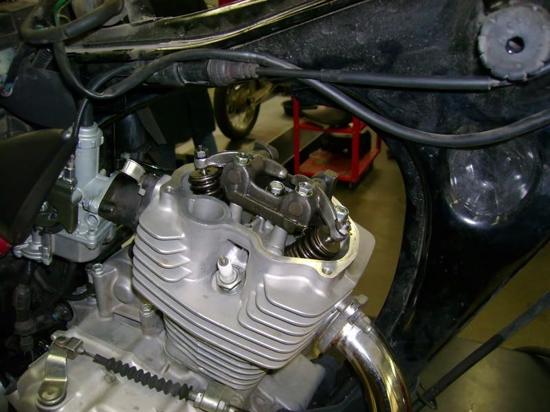

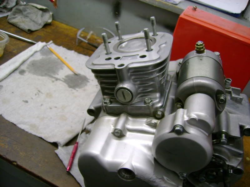

Engine in the frame with the valve inspection cover removed. As you can just barely see it's a push rod engine. The means the cam is located in the bottom end and the valves are activated by levers that are pushed up by the rods on the far side of the engine.

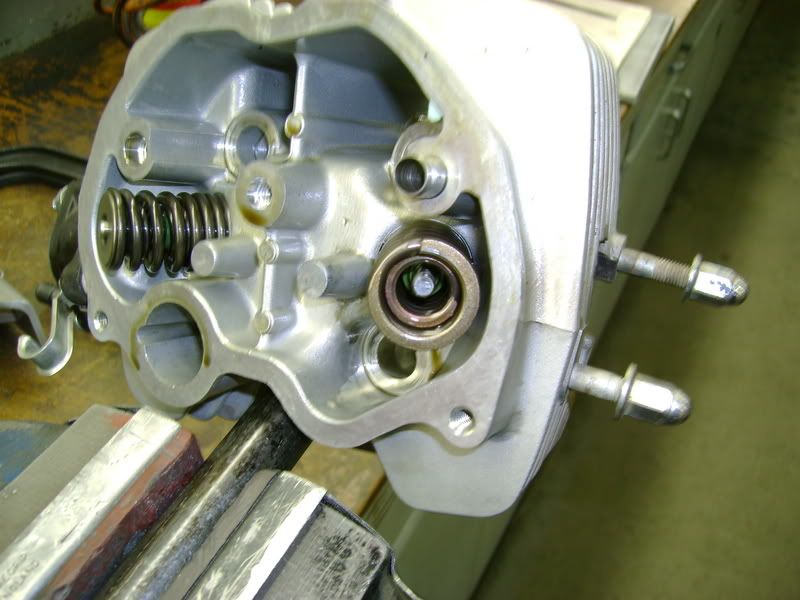

Cylinder head, with one valve partially removed.

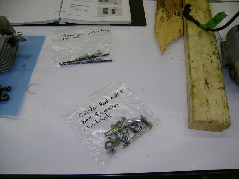

Label everything explicitly.

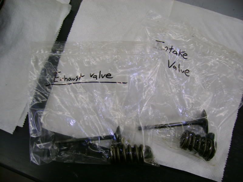

Valve parts.

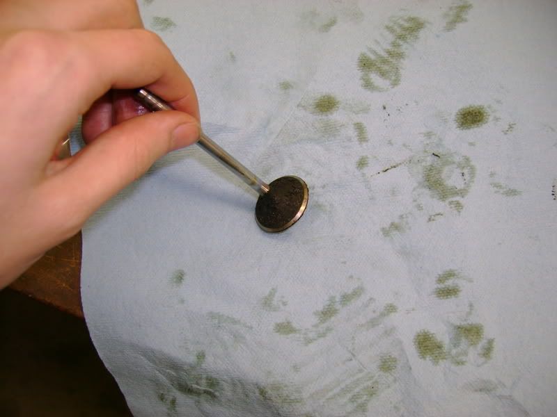

Exhaust valve that's carboned to HELL!

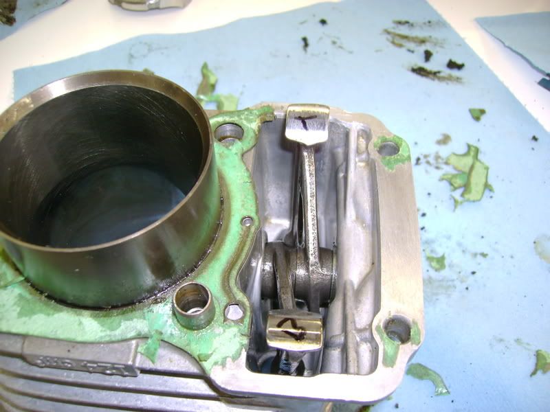

Here you see the underside of the rocker arms. Those worn pad looking things are what ride on the camshaft. As the cam passes they are lifted up and push a rod that activates the valve at the top of the engine.

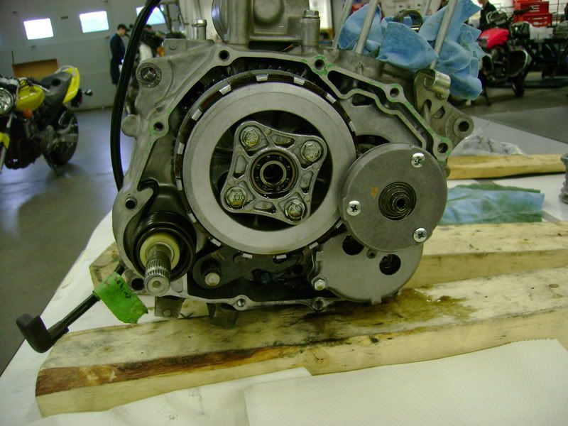

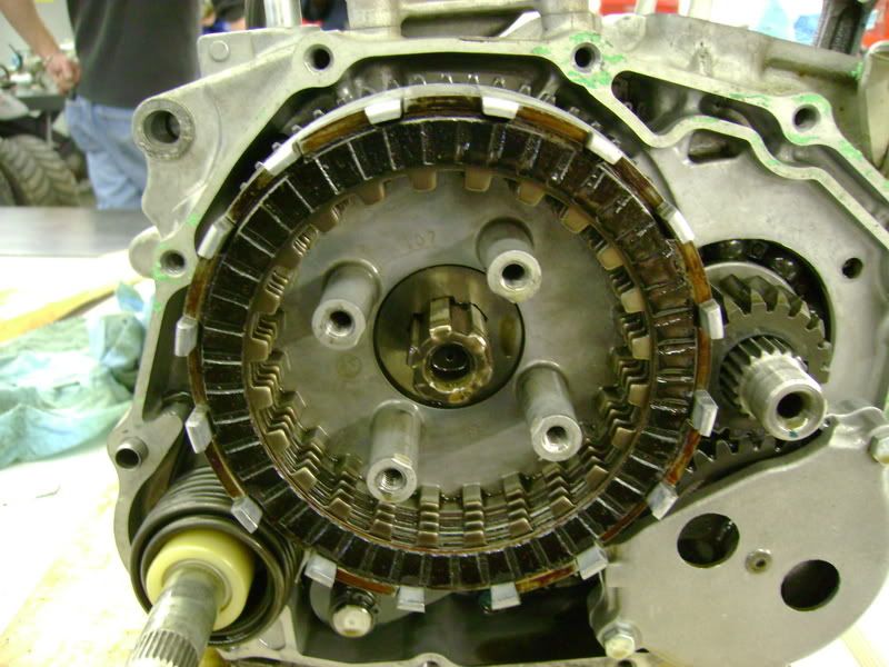

Here's the clutch
Here's the insides of a clutch.

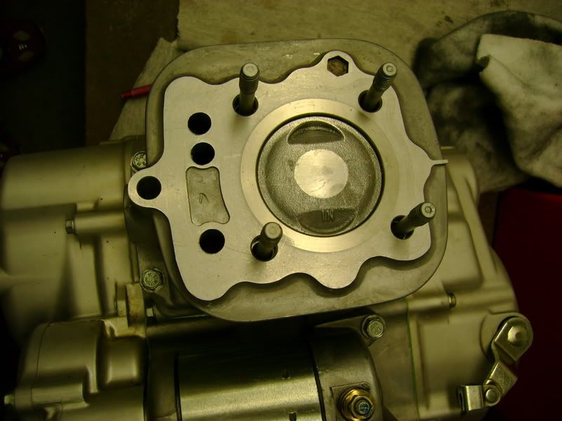

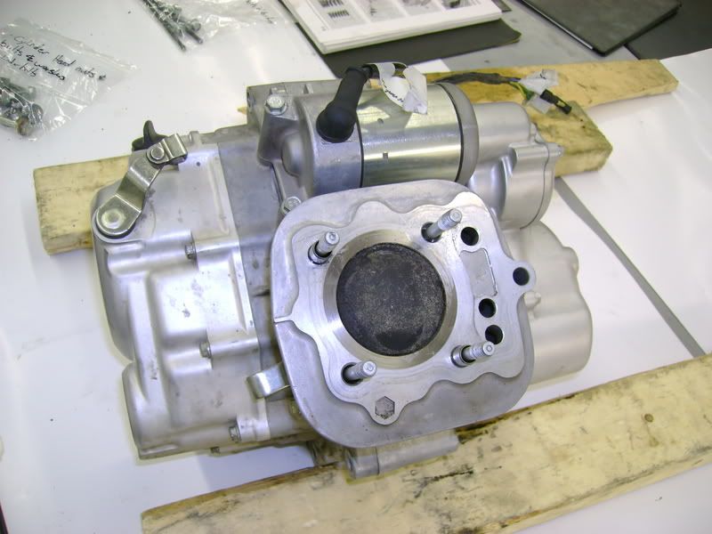

Piston should look like this...
Got it into the frame today, and other parts bolted on. Hopefully I'll get it started and running tomorrow.
