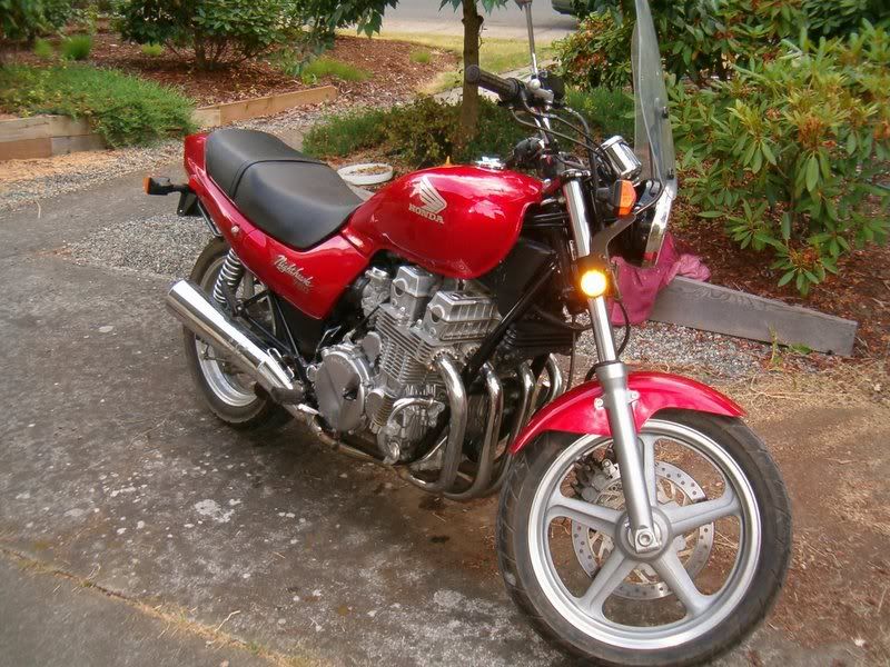

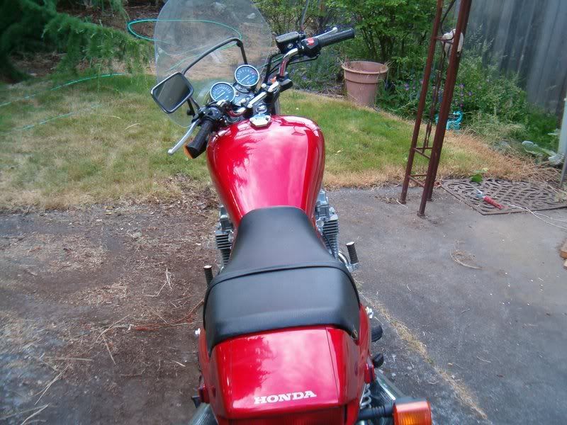

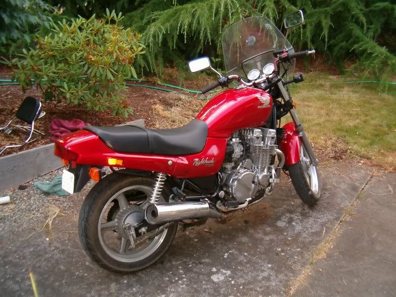

Hey all,
After passing my MSF course a few weeks ago and doing some flip-flopping between bike choices, I found a 1991 Honda Nighthawk CB750 in the classifieds for $3200. The guy was the original owner and it only had 3700 miles on it! I rode the bike and it stuttered a lot, and there were pinging noises in the gas tank. I offered him $2500 on Thursday and he accepted! Against all my better judgement I rode it the 35 miles home expecting it to die at every intersection, but it made it home fine. The performance of the bike improved greatly (it had been sitting with gas in it for 10 years!), and after pumping out the remaining old gas and giving it some higher octane, it has been running like a champ. I've ridden it another 100 miles or so over the weekend with no stalling or other problems.
My question is, should I still take the bike in to the shop this week even though it seems to be doing fine? From the original state the bike was in, I was told by people on this forum that the bike would need carb work. I'd really like to save the money, but if I'm doing damage by running it I better do it now. Are there any additives that help clean carbs/old engines? Also, I have been riding on the original, 15 year old tires. They both have plenty of tread, but the front has quite a few cracks in the tread wells. The front looks like it needs to be replaced, but can I get by with the original rear tire for a little while? And finally, where should I get my tire(s) replaced? How long does it take a mechanic to replace tires, and how much does that cost?
P.S.: Does anyone use Marvel Mystery Oil in their bikes?
Thanks!

Hey, glad to hear you got the Nighthawk! I figured it was old gas.
As for cleaning the carbs, I wouldn't worry too much about it. Ordinary gasoline comes with some detergents already in it. Just concentrate on getting some miles into the bike so that the old stuff gets completely flushed out.
I would; however, worry about the tires. Get them replaced the first chance you get...both of them. Most shops I know will mount and balance your tire if you buy it from them. You can ask them to do a quick once over to see if anything obvious is out of whack. And if they do spot something, ask them how much it'd cost for them to repair it. Some people on this board is very good at assessing costs for all kinds of repair. Some are actually professional mechanics. I'd start up a post if you are curious.
Oh, and more thing - Do an oil change. Chances are, the previous owner didn't bother with the oil change. It's very easy and will give you a starting point on when you should plan for the next change.

What I mean is, 3700 miles is not something to be excited about. That's a BAD thing! I'd be happier if the bike had 37,000 miles on it, since at least then I'd know the owner used it, maintained it, and gave a crizzap about it. Sitting around with bad gas in it will dry up the engine seals and very well could lead to a catastrophic failure, such as a blown head gasket or costly transmission leak.LJTurtle wrote:I found a 1991Honda Nighthawk CB750...and it only had 3700miles on it!
I'm not trying to be a wet blanket, I'm just bringing a little reality to the discussion. The bike needs to be looked over very well by a professional to make sure the brakes are functional (most likely need a fluid change) and everything else is up to snuff.
