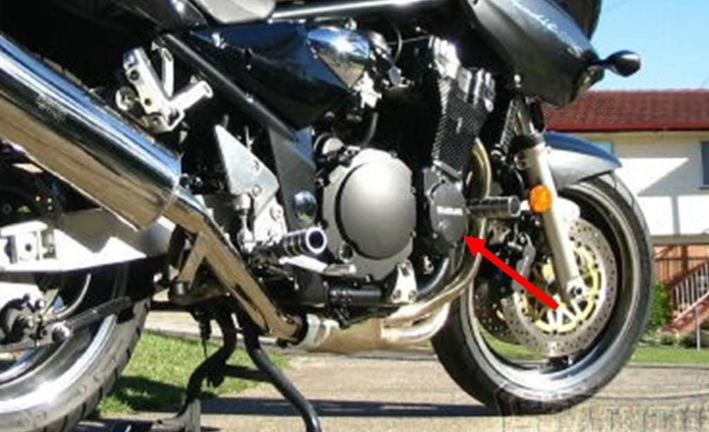

#1 Unread post by Decoy »
Noticed last night that the garage smelled and saw a small puddle under my bike, it's a 2004 Suzuki Bandit 1200S. I'm going to try and include a picture (not my bike but an attempt at finding out where the leak is coming from). I have close up pictures that I can try and include this evening. Any help would be appreciated. The arrow in the pic indicates where the leak is coming from. My question is what is this and what can be done to fix it. My ameteur guess is something to do with the crankcase and hopefully a gasket/seal issue. (The leak is actually on the left side of the bike)
Sev
Posts: 7352
#2 Unread post by Sev »
Looks like crankshaft access to me. But the picture isn't all that good. What does the garage smell like?

#3 Unread post by Decoy »
I have close-ups at home that I'll post tonight. Smells like fuel, it's a clear/yellowish fluid.

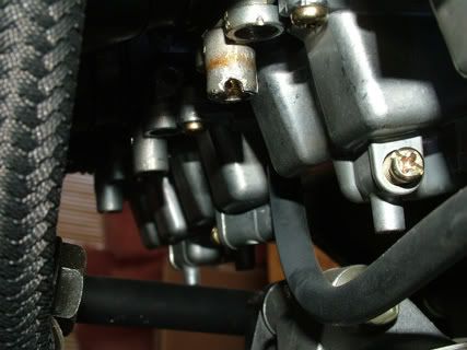

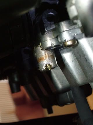

Decoy
Posts: 10
Joined: Wed Sep 01, 2004 3:12 am
Location: Indianapolis
#8 Unread post by Decoy »
BuzZz, you were right on, see attached pics. What's my next course of action? I think it's strange the leak could be at the top of carb?
Thanks again for your input and let me know if you have any ideas.
BuzZz
Posts: 4726
Real Name: Never Used Here
Years Riding: 47
#9 Unread post by BuzZz »
Cool, you got the leak narrowed down some.
Now you got to take stuff off to get a better look. Stuff like the tank and seat, any side panels that block the view of the carbs... junk like that. You can probably leave the airbox in place, that's a P.I.A. to remove on alot of bikes. What you want is a clear view of the leak where it appears in the carbs. It could be a leaky fuel hose or fitting.... if your lucky and have been living right.
If you're like me, there will be a large junk of the casting busted out, evidence of flames shooting out, and the carb will be ruined. Chances are, you're someplace in between. :wink:
You might have a leaking gasket or diaphragm in an accelerator pump or something, but you need to see where the fuel is coming out to start looking effectively.
As a consolation, if it is a bad gasket, etc. you need to remove the stuff you already have to get the bank of carbs out anyways.....

Decoy
Posts: 10
#10 Unread post by Decoy »
Actually got REALLY lucky, I removed the adjustment screw where the leak appeared on the carb and the o-ring on top of the spring looked bad. Changed it out and looks like that was it! Thanks for the help.
