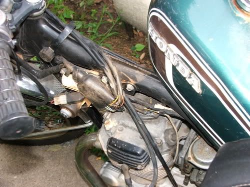

I have bought a dismantled 1974 cb360 and am trying to get in back together. I would like to know where the wiring loom should run....
At present I have it starting on the right side by the battery box, then going forward and crossing over to the left side above the carbs, and then running forward on the left. The "cup" at the front has ended up pointing to the sky which I suspect is wrong.
Can anyone help?

On mine it goes from the left side of the Batt box (more or less from the fuse block), then above the left air filter, inside and over the carbs, then the front looks like this:
Not the best picture in the world, but hope that helps. I can take another pic if you need to look at something, but PM me. I don't check this board much.
