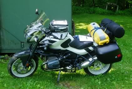

PLEASE PLEASE PLEASE do not depend on bungee cords to tie stuff down on your motorcycle. Sure, folks do it all the time and 'nothing bad happens.' Folks also ride every day without helmets and most of them don't get injured either.if i go on a trip and take a bag and pillow with me i will need to strap it to my backseat. i have a dumb question... do i just use bungee cords or do they make a special bike cargo net bungee? and is there anything i should know about packing up for a trip?
The wind can shift stuff (especially bulky, lightweight items like a sleeping bag). A sharp turn can shift stuff . . . off the seat and into your wheel. At 65 mph that will be catastrophic.
Get yourself some Rok Straps (have a short section of heavy duty stretch strap), or get a set of the Helen2Wheels straps. Why take a chance when you can get reliable, safe tie-downs for about $20?
I've used both the Rok Straps and Helen2Wheels. I prefer the Helen2Wheels straps because they snug down well and do not shift or loosen until I need them to. Here's a pic of my bike packed to the max with both the Rok Straps (black) and my H2W straps (the blue straps).
