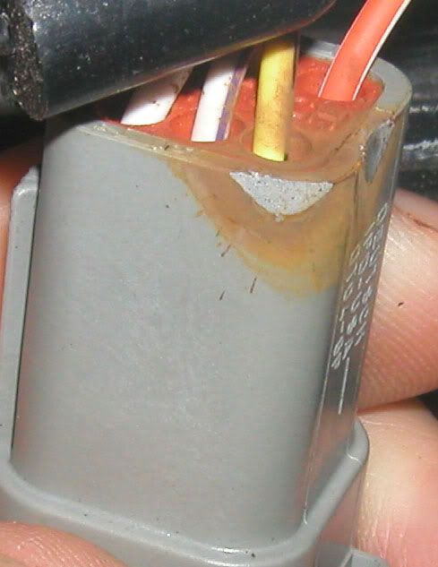

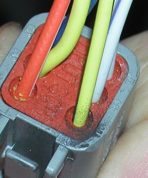

well I think I found the problem
and it leaves me with a bigger problem.
I can't seem to find these two parts online, any reccomendations? I was thinking about putting a new headlight anyway, should I just do that instead of trying to fix this one?
(I don't want to wait too long to have a headlight)

Is that the plug to the headlight from the harness? You may have to splice in both halves of a different connector. I probably would have to, but I'm an electrical hack.

I think splicing's probably your only option if the short is internal to the plug. If the plug was shorting out to the headlight housing, maybe you can just wrap it in rubber or plactic and tape it up?

You're not likely to find a 6-pin square connector in an auto parts store. Do you have a bike wrecking yard in your area? If not, the next best thing is to go to the auto parts store and buy two sets of the flat, rubber coated 3-pin trailer connectors and splice them in. Get a good set of wire stripper/crimpers and a box of blue barrel type crimp-on connectors and you can have the job done in under and hour.BikesnBeer wrote:That is one of the 2 connections, obviously I need a new one, and I can't find where to get one!
Looking at the pics you posted, that brown stain on the one connector looks like rust; I'm thinking it was lying in a small pool of water which seeped into the plug and caused the short.
