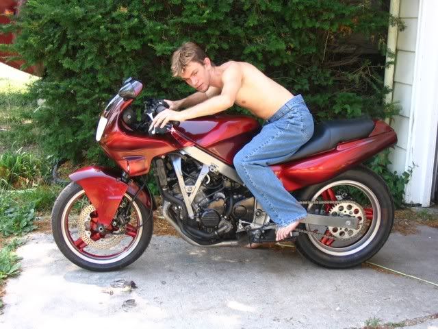

The only rattlecan clearcoat I can recommend is the Duplicolor High heat clear coat. If you can get it to you, that is. The rest I've used aren't Gas-proof, including Duplicolor truck van and SUV paint. I would think the epoxy-based wheel coatings would be good, too. I'm not sure you can rub them out, though...never tried...not worth it on a wheel. Even though it's just a rattlecan job, you don't want gas to eat it. For example...This is a rattlecan job...Still alot of work.Image

ronboskz650sr wrote:The only rattlecan clearcoat I can recommend is the Duplicolor High heat clear coat. If you can get it to you, that is. The rest I've used aren't Gas-proof, including Duplicolor truck van and SUV paint. I would think the epoxy-based wheel coatings would be good, too. I'm not sure you can rub them out, though...never tried...not worth it on a wheel. Even though it's just a rattlecan job, you don't want gas to eat it. For example...This is a rattlecan job...Still alot of work.Image
Aaagh! I did it again! I can't stop...Help me Gene!
awesome looking bike! Wouldn't have guessed it was a rattle can job!
