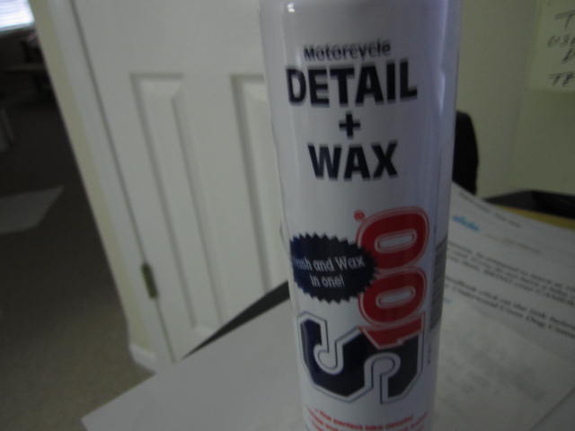

Re: Cleaning Chrome Exhaust
I use this for everything,boot barks and what ever get on hot pipes. I scratched mine trying to get boot marks off. you might want to try this. 9.95 at H-D dealer.
- detail & wax
