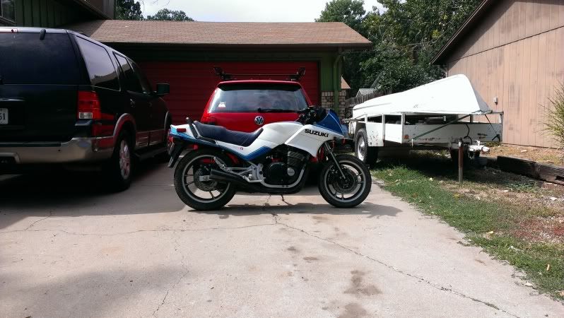

Hello mzeffex and welcome to the forum. Sounds like you need to clean your gas tank and put a fuel filter on it. How about a picture of your bike?

Re: Suzuki GS550ES all kinds of issues
Good looking bike. It'll be worth it when you get it sorted.
