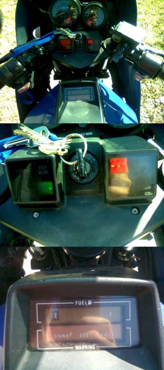

What is this light you speak of? Is it on the face of one of the instruments or is it in a little stack of around 4 or 5 lights between them? Is it marked? Kawasaki`s from that time had a red light on the dash that would light up every time you used the brakes.

Re: 1984 Kawasaki GPz 750 not starting immediately
Here are a couple of pictures of the control area.
At the top we have the warning light. It flickers in time with the low fuel light, which flickers regardless of the amount of fuel in the tank, so that's broken for now. I'm hoping that the warning light is just a warning that I'm low on fuel, even though I'm not. Does that sound plausible? Because if that's the answer, I just need to fix the gas gauge, which is surely cheaper than a mechanical problem.
