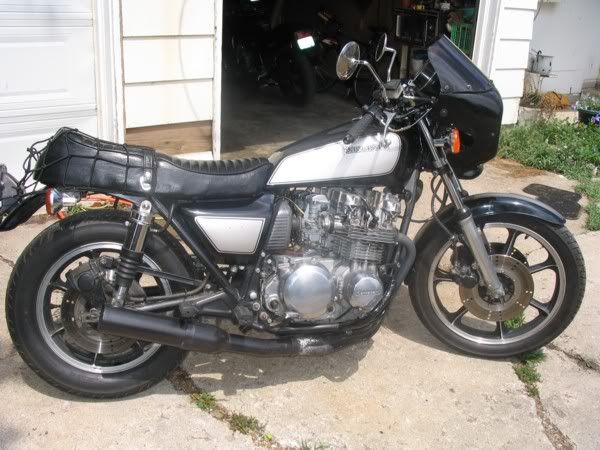

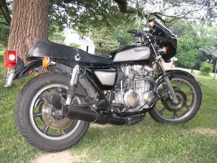

Here's a pic with the superbike bars dropped
Here's before:
Both are with bars in the full right position. The drag bars will be forward a couple of inches, but about the same height as the superbike bars . I'm getting drag bars with 0 rise and 3.8 inch pulback. Next thing will be fabricating the bar-end weight/mirrors.
Oh...I didn't mean to imply any discomfort in the wrist. Just some unusual inputs from me due to the new position. I'm also riding without a return cable until probably tomorrow, so I have to take it easy..the throttle return spring is a little slower than closing it yourself. Strange, but true.
Here's before:

Lookin' good, Ron! That bike is hella clean, too. Did you do any restoration work to it or was it just properly taken care of? My '84 NightHawk was unusually clean, too, but it was mostly due to the previous owners' investment of NOS (New Old Stock) body parts found in the U.K.. So I literally had a brand new, 20-year-old gas tank, side covers, and tail section. It was often mistaken for a mid 90's bike, especially after the addition of a red/black Corbin seat.
I just can't say enough good regarding late 70's, 80's, and early 90's UJM's. Had my finances permitted, I would have held onto that NightHawk. But I suppose it went on to provide someone else with a great ownership experience (the dealership sold it within a week!).
