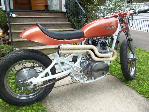

BTW welcome to the forum. Lets see a picture of your bike.

#3 Unread post by purplellama »
thanks. here's a pic
