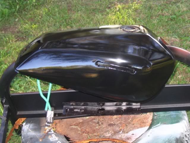

Well, one of my cardinal rules of painting was obviously broken by the PO who repainted my bike. Today when I sanded the tank to scuff it for a gloss black top coat, over the clear...it happened. Right through to the metal on the top contour line! There couldn't have been any extra paint there, judging by how little pressure I was using. Not only that, I see no indication of a primer coat! I feathered it out, thinking I would just fix it, and it never revealed anything but the black and the clear above it. So...here I sit waiting for chemical stripper to remove the old paint, and I'm starting over. That way i know for sure what's on there. I was a little suspicious this spring, when I got a stone chip, and it went straight to metal. This bike was originally red, so I expected a few layers, like what I found on the side panels. Oh well, it's cold, but dry, and within the temperature window to paint, so Here I go again. Wish me luck!

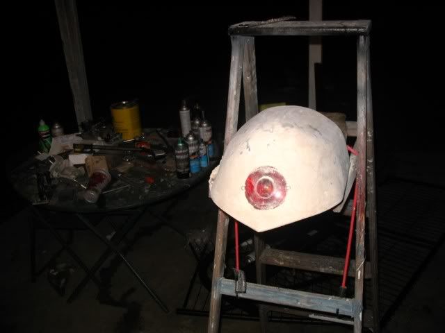

The taillight is molded into the cowling now...coming along pretty well. I'm not too happy with my enamel spraying, though. never was...figured this would be a good chance to practice it. Now i remember why i never got into it...too much waiting time before you can sand it. Takes days to paint something and have it look professional, especially if you need a recoat for any reason. In the meantime, it dries fast, but isn't cured, so you can dent it with a fingernail...wah,wah,wah. Also, one of the side covers lifted in two spots..after taking the enamel just fine. I sanded it out today and recoated, it was the recoat that lifted. I'm a little confused about these side covers, and how the paint is behaving on them. The next step is going to be sanding all the way to plastic, I guess. Doesn't seem to be much choice.

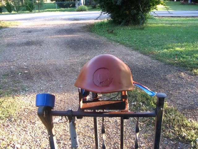

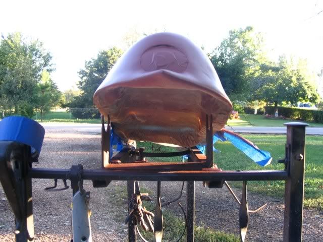

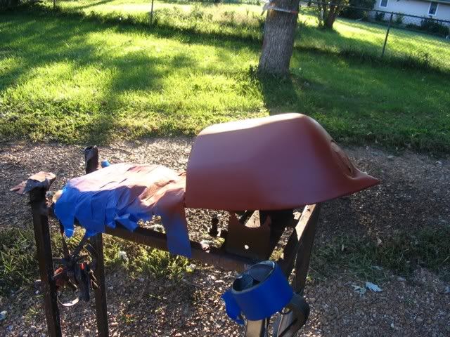

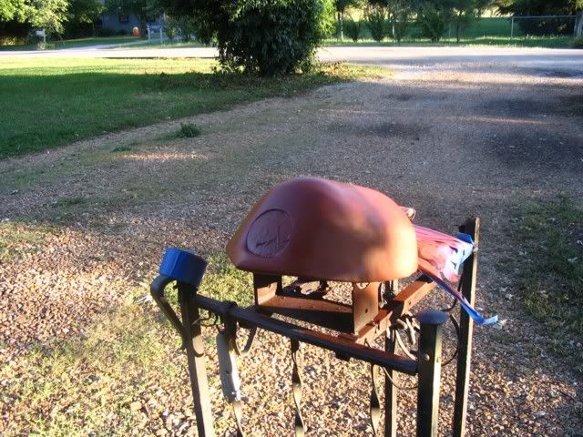

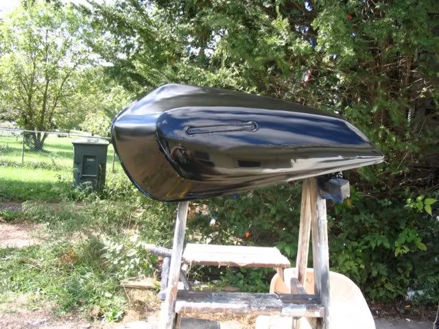

ronboskz650sr
Posts: 995
Location: Sedalia, Mo
Tailpiece in primer
#7 Unread post by ronboskz650sr »
Here's the first stage of primer/surfacing before paint. All the polyester filler has been sanded with 100 grit to a wood-like texture. This give the primer lots of bite. There are 5 coats of sandable primer on this, most of which will be removed...scratches and slight depressions, pinholes etc that are too deep to sand out with be filled with glazing puttty, after block sanding all this with sponge-backed papers of different grits. Looks like a B2 bomber nose.
Especially from this angle...
Ride safe...God bless!
-Ron
