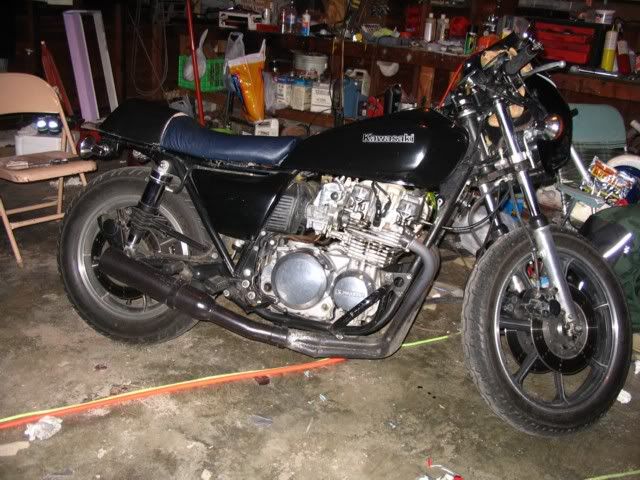

Well, I know pride goith before a fall...so I want first to thank you guys again, particularly BuzZz, and Techbmw for the contiuous support while I fiddled around with my bike in ways I was truly unqualified to.
Now for the gloat. The bike is just drop-dead gorgeous! This is the first time since I've owned it that people look to see what's coming, then turn as a group to watch it go by. Now people are taking side trips in the parking lot to get a closer look at this old 26-year old UJM! The paint is blinding in the sun, and the look is unlike anything around. I must admit, I'm very happy with the outcome. I'll post some pics in a while..the seat ended up being Navy Blue! The gallery pic is way out of date. The front fender is a work of art now, too (thanks BuzZz). I'm finishing up some details, and have the bike apart again, so I need to reassemble and wash, and Il post pics. And the ride is fantastic! Never would have suspected a lower (almost 3 inches in the end) seat would affect the handling that dramatically, although it does make sense, cg-wise. And the weight reduction is even noticeable when I push it around in the garage...almost 10 pounds lighter, final tally.
Thanks again everyone for being Totalmotorcycle!
Teaser pic with front fender still off and test seat, tail not final painted...

Thanks BuzZz! I'll be able to post some pics tomorrow...The cropped front fender is on! And you will like it, i'm sure. I mimicked the tail point on the front, and the effect is subtle, but very cool in gloss black.
I still haven't totally finished the seat, but can say with confidence that I can do it, now. I figured it out. A few tweaks to the pan, some batting material, and a couple of new sewing techniques later...I'm ready to make a permanent cover when the weather crumps on me. For now, it's still looking pretty darned good for a temporary. I must ride, and I have been...hence the delays in the project lately.
BTW, Krylon fusion is very tough paint, and CAN be buffed to a custom quality shine. I think someone was wondering about that, and I used it on the side covers with outstanding results. I plan to repaint my tank with Krylon Rust tough to test its gas resistance (can you tell my riding hobby goes deeper?), and I'll post that when I do it. I've learned a ton doing this, and will lurk so I can pass on anything helpful. I will also paint the exhaust with rustoleum high temp and report on it.
