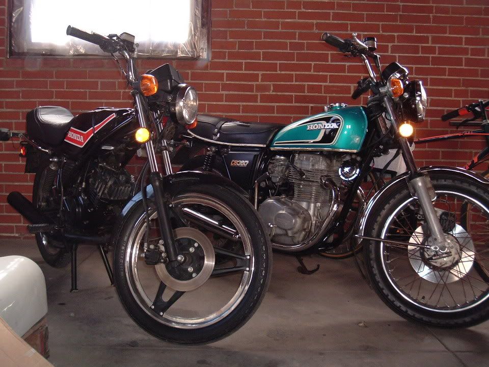

i have cb360 that im trying to get running this winter...ive cleaned it up good and put many parts on it...i just picked up a battery last night and charged it and threw it in the bike today and all the lights and everything work but when i try to hit the electric start button nothing happends except the lights get dim...it does have a kick start but i am just curious as to why it wont do anything..btw i just replaced the right side electrical controls and throttle cables
heres a pic of it
cb360
