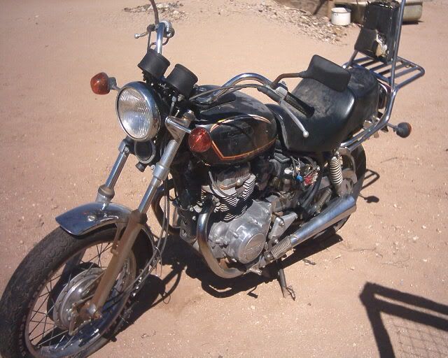

Looks identical to my resto project, a 1980 CM400E, aside from the luggage rack and backrest that is! I got ahold of this one back in August for the grand price of $FREE. It' got 16k on the odometer and yes it runs!
