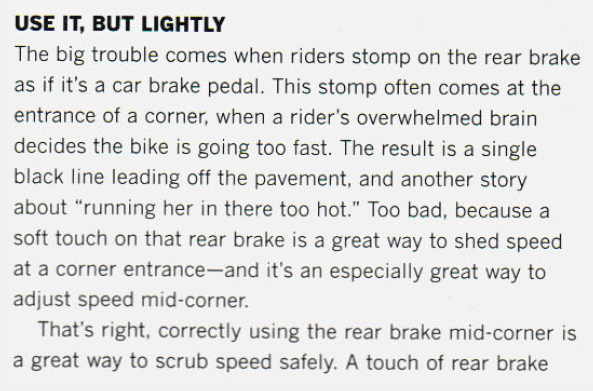

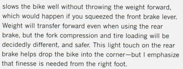

gsJack wrote:Learn to use all three of your brakes all the time; front, rear, and engine.......................
I spent a lot of time trail braking hard into corners using all three brakes a few years ago just for the fun of it. Ienatsch is right on in the quote above, your rear brake can be your best friend in corners.
