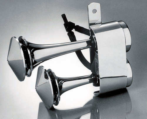

These have never had that problem...
#142 Unread post by totalmotorcycle »
dr_bar wrote:These have never had that problem...
Wow, those are crazy mad horns! :D
It looks like it needs an accessory compressor?
P.S. It's raining out today so no photo (yet) of the horn mod. Maybe tomorrow. :revv:
#143 Unread post by dr_bar »
Yes, they come with a separate compressor, they are very loud... :)

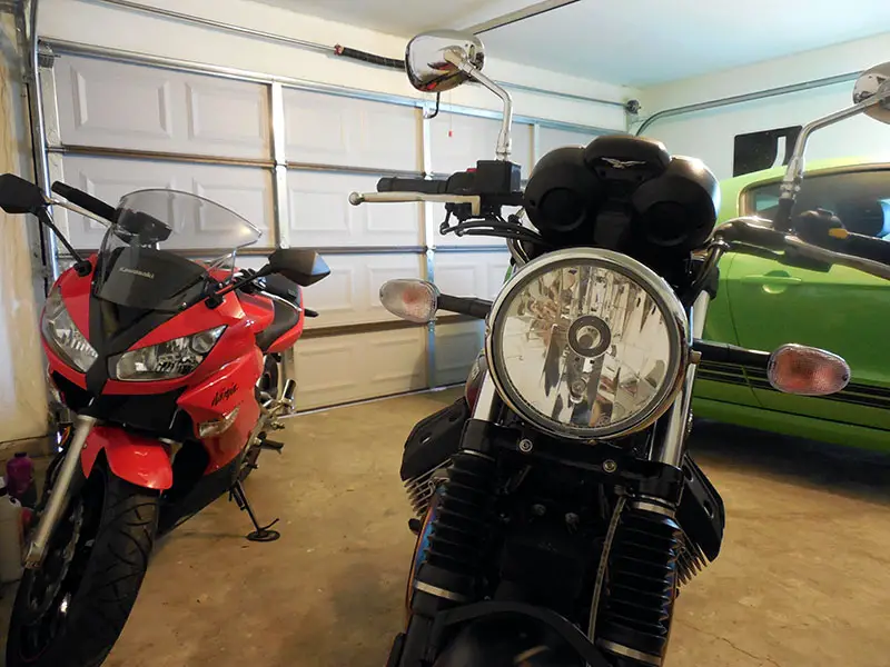

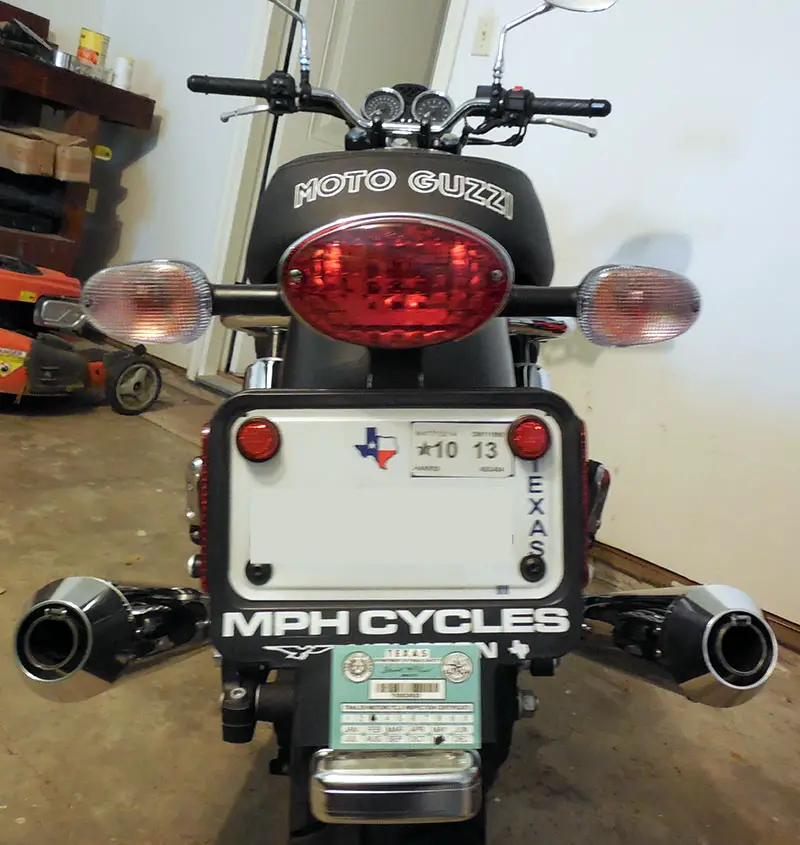

I ordered up some new clear turn signal lenses for my Guzzi and installed them today. $18 each pair on eBay with amber bulbs. They look quite nice (IMO) over the stock orange ones as it seems to better fit the black and silver look more.
New lenses
New lenses
Stock lenses

I would take my Airhorns off the Valkyrie, but the only real mounting spot recommended for the RoyalStar Venture is, rear facing, down on the swing arm. If I was going to do that, I'd have just bought plastic horns...
