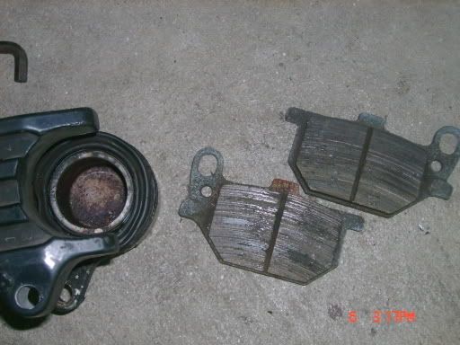

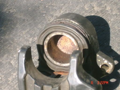

I've had my Yamaha XJ650 maxim for about a month now, and after collecting gear and getting comfortable with riding (finished MSF course as well) I was ready for my first long distance ride (~45 minutes to campground). After about 15 minutes I slowly began more and more aware of how fast the bike was slowing down, and it was just acting weird. Finally it got much worse and at a stoplight all the pieces came together when I saw smoke coming from the front caliper. I was in the middle lane so I needed to cross the rather large intersection to get to a parking lot. When I tried to launch I stalled it cause of the brakes, then restarted and dumped the clutch at like 4 grand to get it moving and into a parking lot.
After it sat for a while the brakes ended up loosening up and I drove it home just using the rear brake for fear of a re-occurance.
What could this be? I took off the pads and caliper and didn't see much, except they are old and gummy. My inclination is that the caliper is just bad, but I'm not sure. Any help would be greatly appreciated, I'm trying to avoid taking it in and paying an arm and a leg for something I can do myself. Below are some pictures.

Looks and sounds to me as if your brake pads were rubbing on the disc, transferring frictional heat to the brake fluid - when the brake fluid heated up, it expanded and exerted more pressure on the brake pads, yada yada yada.
Get yourself a shop manual for your bike and a rebuild kit for your front caliper, then pull it apart, clean it and rebuild it. I would also recommend changing your front brake pads at the same time.
This is a job that you can do yourself with a few tools, a modicum of mechanical skill (the ability to follow the instructions in the manual help) and some time.
if you aren't comfortable doing this, then you can take the caliper itself to a shop and have them do it.

How does the brake fluid look? I had something similar happen to me on my bike. I had just bought it from a guy at work and I had ridden it for a few days. When I went to pull it out for a ride at night, the bike wouldn't budge. The front brakes had locked shut on the front rotor.
The next day I pull the caliper and notice rust on the outside of the pistons. I cleaned them with some scotchbrite pads but the pistons wouldn't retract. I opened up the brake master cylinder and it looked like warm chocolate ice cream (YIKES!!!). Since brake fluid is suppose to be clear, I knew this bike had not had the brake fluid serviced in a long time. I drained the fluid and cleaned out the brake master cylinder with q-tips. I then flushed some new clean fluid through the lines and then bled the brakes. The caliper and pistons worked fine after that and I've enjoyed 4k miles on them since.
I'd verify the brake fluid before you go rebuilding your caliper. It's the cheaper and faster fix.

It probably will require taking the piston out. There are some o-rings there that the piston slides against. I didn't need to do it, but my service manual mentioned a method to get the pist out. If you have an air compressor, bet the blowing attachment and blow some compressed air into the open bleeder screw hole. Have a towel or something ready to catch the piston as the air will push the piston out. Not sure if this is possible with your caliper, but worth a shot...
Yeah your local yamaha dealership would probably be able to order you a rebuild kit. It is probably something they don't normally stock.
