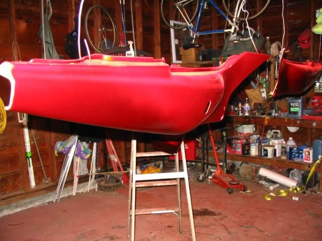

Here's a pic of the early stages of paint. He shot gold metallic, then candy red. This is before the gunmetal gray fade between the red coats:

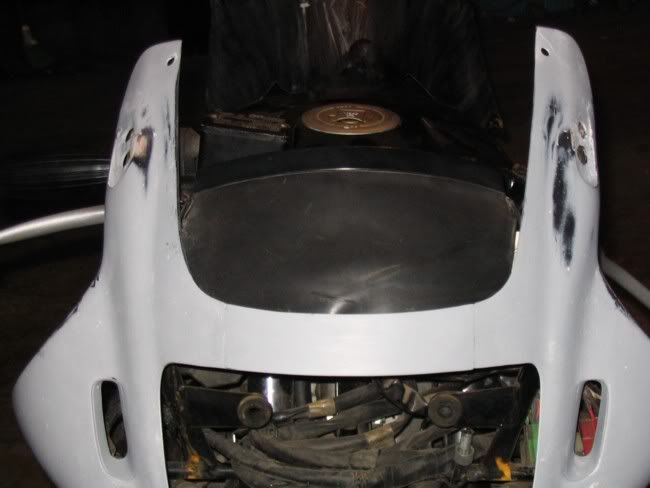

Here's the front faring and all the bodywork he did to fit cbr 954 mirrors to it. Everything from the mirror mounting hole area to the headlight opening is reshaped:

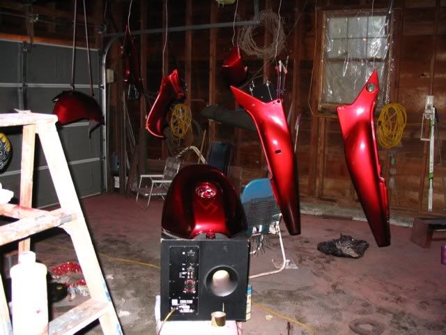

And heres a shot showing the completed paint scheme, except for the front fender and faring. This is after the first buffing compound. Everything is wet sanded with 1500 prior to buffing, not to say other grits weren't used before that:

Thanks, guys! We're still experimenting with photographing these pieces. The glare is a problem in most lighting, and doesn't allow the camera to do it justice. Any flash just wipes out the area when it bounces off the metal flakes a few layers down below the candy and clear coats. Direct sunlight does it, too. That's why I'm casting a shadow over the tank...it's the only way I've been able to capture the gloss at all. Not to complain, I guess there are worse paint problem to have! (see first photo :laughing: )
