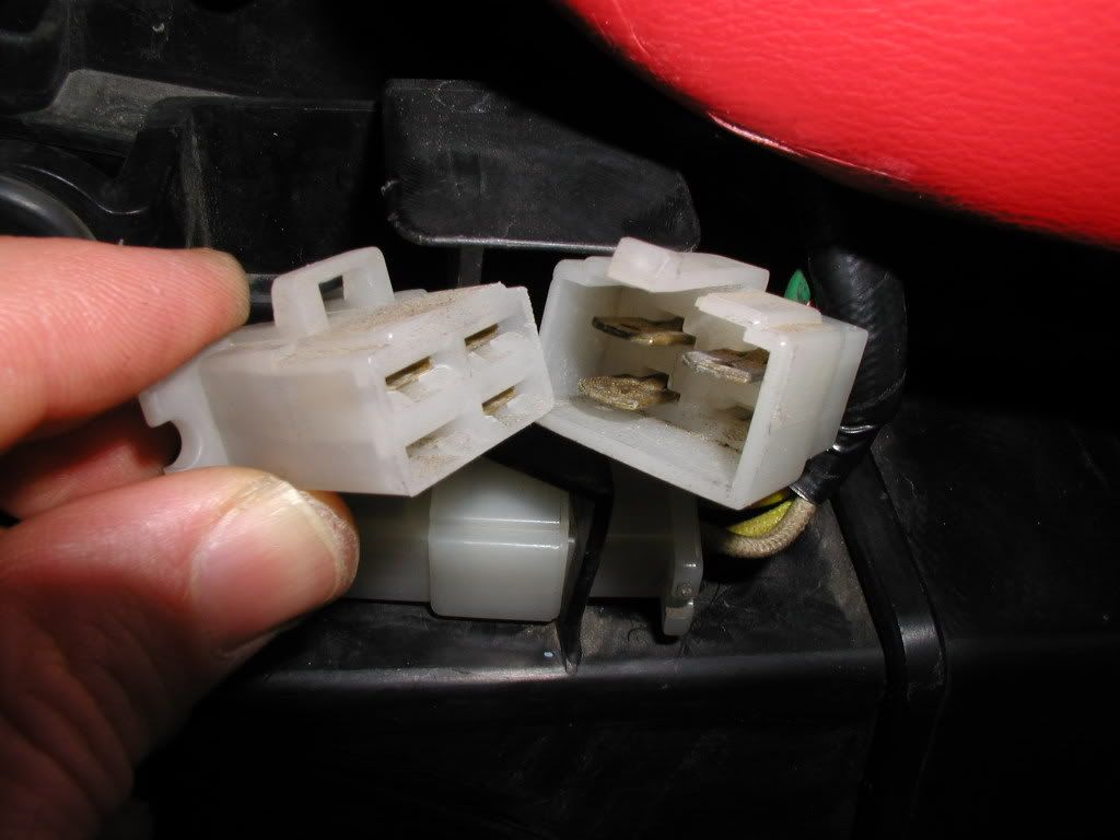

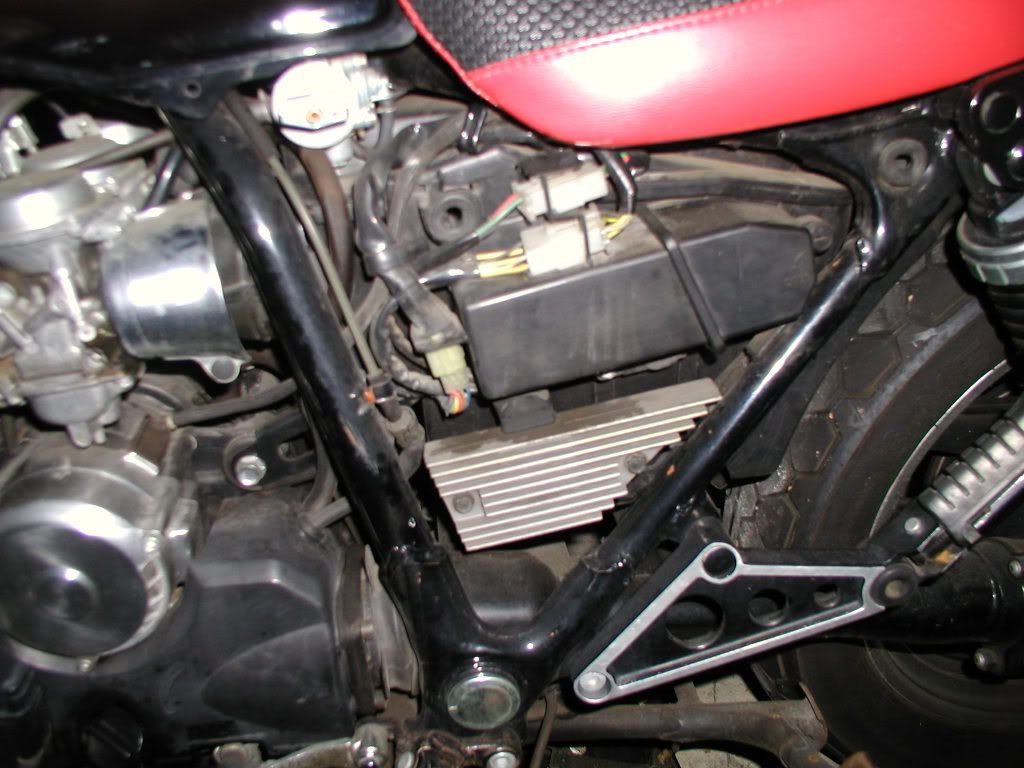

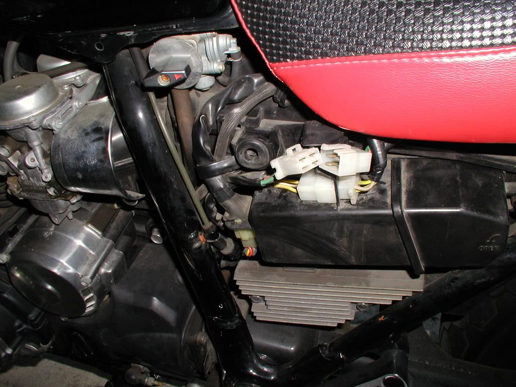

Question? - Are all the fuses in the white plastic fuse boxes on the motorcyle live, active fuses with current in them? Because there was one or two fuse ends that did not light up with the fuse tester when i contacted them. Although they were in fuse container next to two ends that did light up as working correctly.
A few photos of the fuses on my bike are here -
One of the fuse types, the bottom photo just above this line of text, where the fuse tester says the 2 fuse ends with the gap between them light up as good, but the row of 3 in same fuse container did not light up, signifying they are broken or not working (?) or do they not matter, are some kind of spares? How do i actually replace these types of fuses? They are not the kind Kragen sold me as being useable for my bike, unless Im really not seeing them correctly?
These are the fuses Kragen sold me -

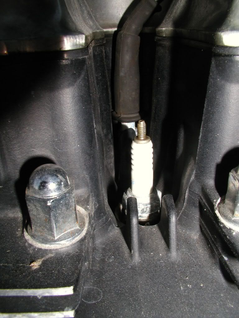

I also noticed today after putting new battery in, when i came back and looked closer at the spark plugs that the rubber condom looking cover that snaps over them was not fit all the way down to the bottom of them as far as it could go. Unfortunately the spark plug farther back in the crevice was too cramped too reach with my fingers and i tried using a pair of needle nose pliers which made a tear in the soft rubber condom fitting over that spark plug. Though it seems to mostly come back together rather than leaving a gaping hole.
I cant figure out how to get that back spark plug completely covered by the condom rubber joining piece without ripping it more.? Any advice on that? And how far down the rubber condom piece should snap over and come down over the spark plugs? There seem to be a few circular ribs at the bottom of the condom rubber cap that fits over the spark plugs, and i think that it has had more room to snap down over the plugs since ive had the bike.? I took a photo of it after my ride today, the one with the black condomy cover still over it toward the back is covered as completely & incompletely as i think it has been since i bought the bike and have been riding it.? They were both like that actually.
Here is a photo of the spark plugs -
Could that be causing / contributing to some of the not starting, backfiring
dying and poor acceleration issues aside from the battery?

Ocean, those aren't fuses, they're plug-in electrical connectors. Don't take them apart. Your fuse box is somewhere else on the bike. I don't recall where, I'll look in the manual at my local bike shop tomorrow, but you'll probably find it enclosed in plastic somewhere under the seat section. But if all your lights and components are working, then your fuses are all good. They don't slowly go bad, they just break if something's wrong in order to protect that component from frying. Fuses have nothing to do with poor idle and stuttering on acceleration. Bad jetting or dirty carbs often do, though, so I'd look there first. Still, get the electrics now and *then* worry about carbs. Looks like you've done that with your new battery. Remember to check it once a month, even in the winter, to make sure it isn't going dry!
I don't think there's a problem with your plug wires. If they weren't doing their job correctly, the bike would hardly run at all, and you say it's driveable. I assume these plugs are right for the bike but simply different than the original plug wires are made to fit, much like the ones on my '92 Nighthawk that don't quite cover the plugs. Don't worry about them yet. You probably have to remove the tank to get at them. If you do remove the plugs, make sure you get ALL the dirt and sand and funk from around them before you loosen them, so NOTHING gets in those holes and into the engine!!! You will mess up your bike BAD if you let ANY dirt get in there!
