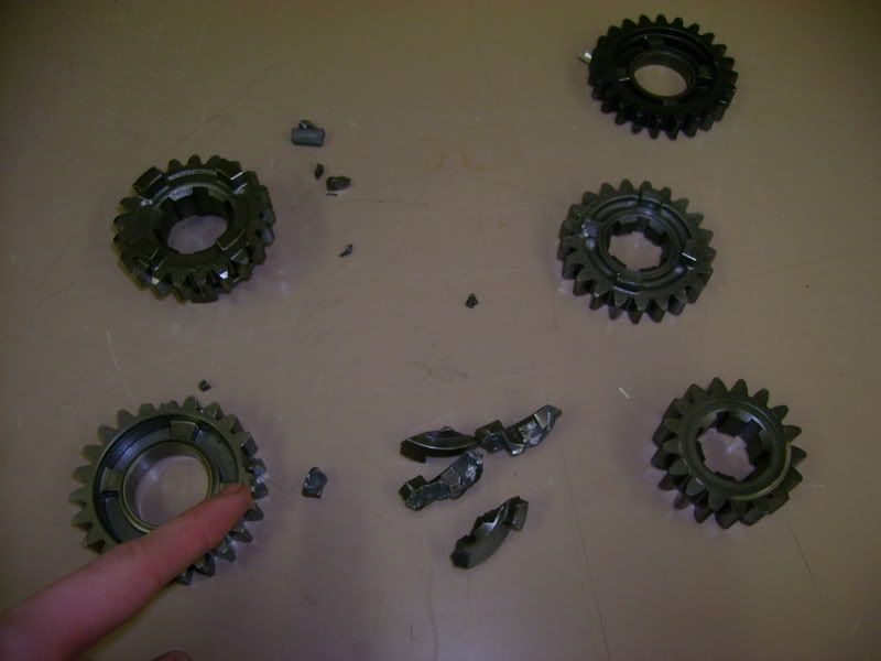

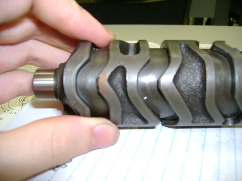

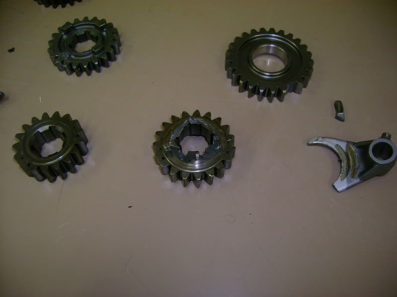

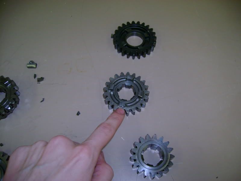

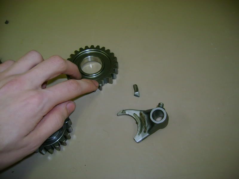

Sev
Posts: 7352
#8 Unread post by Sev »
Hmmm your engine, your choice. This is what clutchless shifting can do:
It's your engine... no one is going to make you do anything to it.
HYPERR
Posts: 3159
Location: CT, USA
#9 Unread post by HYPERR »
I said clutchless upshifts when done properly causes no extra wear on tear on the transmission. I also stated that clutchless downshifts should not be done as it can cause damage to the tranny.
When clutchless upshifts are done properly using the technique I that posted, the upshifts will be ultra smooth and slick that the gear will literally snick right into next gear almost silently.
I'm sorry to hear about your bike. What kind of bike is it and what happened?
Sev
Posts: 7352
#10 Unread post by Sev »
Customer's GSX-R he was clutchless upshifting between 2 and 3 when it happened. BOOM.
