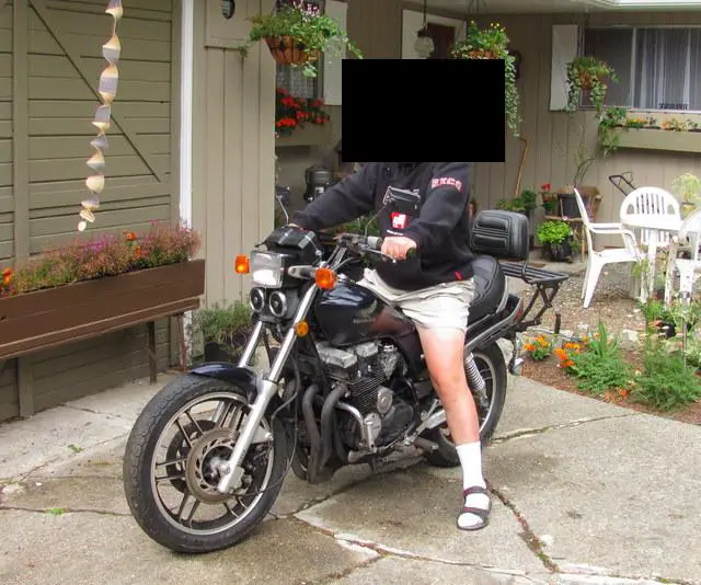

Hi - I just got aHonda Nighthawk 650.
- Rookie
- Posts: 8
- Joined: Sat Aug 28, 2010 4:02 am
- Real Name: Tom
- Years Riding: 0
- My Motorcycle: 1983/nighthawk/honda
The guy said it needs a carb flush and new battery and rubber.
It's my first bike.
I can't afford to pay a shop to do it, I'll be doing as much of it as I can myself and will need help with that.It's my first bike.

Carb flush... that's running a product like Seafoam or any other carb/fuel injector cleaner in your gas. It's preferred that you remove the carbs and thoroughly clean them. For tires I'd go with Bridgestone S-11 Spitfires. Not the cheapest but they're a good overall tire.
The large black box on your head looks good with the shorts, sandals and sox.

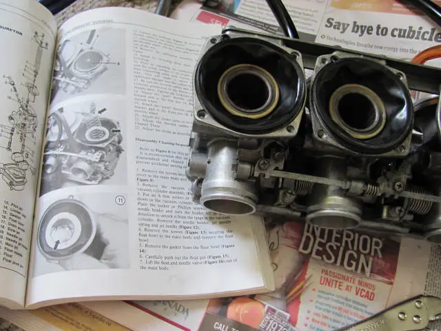

I turned it over but no, it didn't start - I'm giving it a carb flush and stuff.
Problems with the carb flush - the vacuum assemblies wont come out.
The manual gives the impression they just slide out - but they don't.
How do I get them out? HELP!!!
