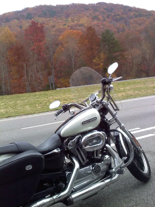

I refused to go with stocks when I knew they weren't taking the problem seriously and let them jack my Reinhardts LOL. The spark plugs will be the easiest thing to check - I should put new ones in anyway after doing a 1500 mile ride. A new air filter will be the easiest thing to do as well. I have no idea how to check if there's a commander on the thing or not, but I have no doubt that HD didn't check the readings or readjust anything for the custom pipes while it was in the shop. It does need a full maintenance on it so maybe I'll ask if they can hook it up and hopefully a different HD will be better but the "new" bike was in the shop for 6 of the 8 weeks I first had it and no solution. So upset.
Here's my baby
Here's my baby
- 1.jpg (94.22 KiB) Viewed 3001 times
