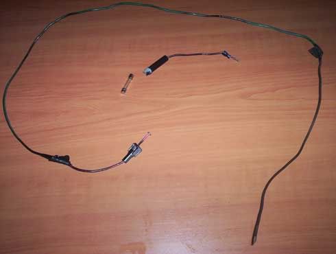

Ok, so today my friend was over, and we got all the electrical working. But the job the guy who had it before me did, makes me a little nervous, so I took a trip to Canadian tire and picked up some supplies to at least redo his make shift job. I might replace some of the other wiring, I'll have to take a closer look at everything, I'd rather not redo anything else if I don't have to, as everything is nice and color coded right now.
You can see in this picture the horrible job that was done. There are 3 different pieces of wire, all differnt gauges, just twisted and taped together. The gauge dosn't even feel high enough to be able to handle 12 amps. The piece that the fuse fits in is in really rough shape, and dosn't stay together well, so I will replace that as well.

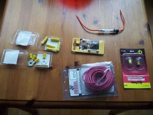

This is what I picked up today, I got the wire to replace the stuff he had, plus new ring terminals and butt connectors. I also got a new fuse casing and light bulbs to replace those that illuminate my tach and speedo.

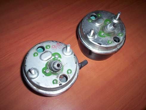

Alright, so the wire I made worked which makes me happy. Now onto my next task. I've taken some pictures of the speedo and tach so you can see the condition they are in. I figure I might as well take a crack at redoing them myself, even if I ruin them, I still need to get new ones.

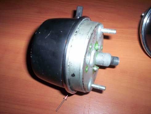

As you can see, the decal or sticker or whatever labels the inside of both, is cracking and pealing off. Also the glass is cracked on the speedo. The both need to be repainted as the paint on the outside is chipping off. My plan if i can get them open is to get some of that sticker paper you can get for your printer, and reprint the insides, except change it to Kilometers on the speedo. I'll try and buy the best grade sticker paper i can get, as I do want it to come out well.
The back on either of them shows no way of getting them open, other then what I guess are rivets of some sort.
But even if I drilled out the rivet things, I still have this band all the way around each to deal with.
So any suggestions I would love. I know it has to be possible to redo them, or at least on some bikes, as a friend had his sent off and redone, but it cost him a few hundred dollars. Which I refuse to pay.

The only way I know of to remove those banding clamps holding the houseing together(those rivits just hold the internals in place inside, drilling them won't help open it), is to carefully pry underneath the clamp with a small screwdriver or similar and work the clamp open. It is thin and easy to work, but easy to mess up too. Then reverse the process to reassemble. It will look like craap. But you might get lucky and get a decent seal.... maybe.... stranger things have happened....
If you do a really nice job, I'll send you my Gixxer clocks, they need new front glass and it's held on with the same kind of clamp. :wink: :mrgreen:
