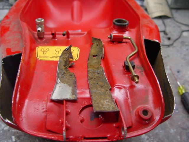

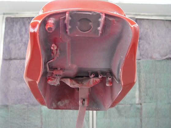

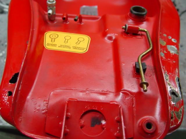

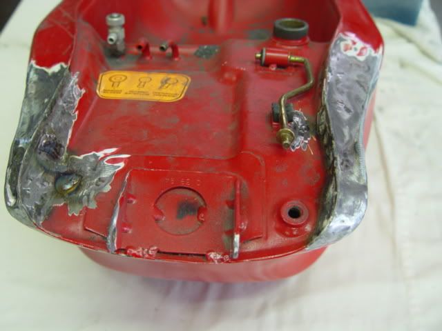

I have repaired many tanks that the owner claimed had a few pin holes, this is an example of what was sent, and what we had to do to make the repairs, it was still less than half the cost of replacement even though the work is so extensive.
This is what the tank looked like when we got it, it does not look that bad
This is how much metal I had to cut away in order to find something with some integrity so I could weld to it
This is with all new steel welded in
Done, repaired painted and sealed
