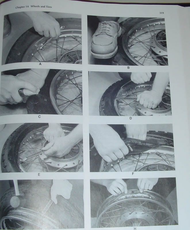

Here is a pic that shows the steps to change a tube-type tire.
You can ignore the part about removing the tube and reinstalling it. you might have trouble breaking the bead with your foot, there are machines that can do it for you. Alternately if you aren't using the same tire ever again just use a table vice to pinch the tire right next to the rim until it pops off teh bead (do not let it hit the rim) and then stomp the rest out.
If you want to check the runout quickly and/or easily, after the tire is off the wheel reinstall the wheel in the swing arm or forks keeping it off the ground. Set up a spray can with a straw on it, so that the straw is just barely touching the rim, then spin it. Do not allow the forks or swing arm to move. Watch for differences in lateral (side to side) or radial (up and down) runout. Check lateral first by having the straw beside the rim, and radial by having it above or below. Realistically it should be zero, but it can be up to 2mm on some bikes and still be considered acceptable. A cast wheel cannot have the runout changed, you just need to get a new one.
When removing the tire use the curved end of the iron, to reinstall use the straight edge.
