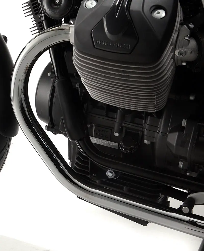

Here is a close up shot of the dipstick on the Moto Guzzi V7 Stone:
Moto Guzzi Stone V7 Dipstick
I wonder how it popped out, hopefully I will know soon.

I have my fingers crossed. What gets me is I've never heard of a dip stick unscrewing itself and popping out and that I did just check it's tightness after going out on that ride too. I have a few ideas to propose to them to see if it does unscrew itself (like running the bike with a orange tick on it and the case and see if it moves or screw it in not so tightly and see if it moves kinda thing). I'm really quite concerned about it all as it is something I really can't see while I'm riding. I guess I could use Loctite on it! LOL
