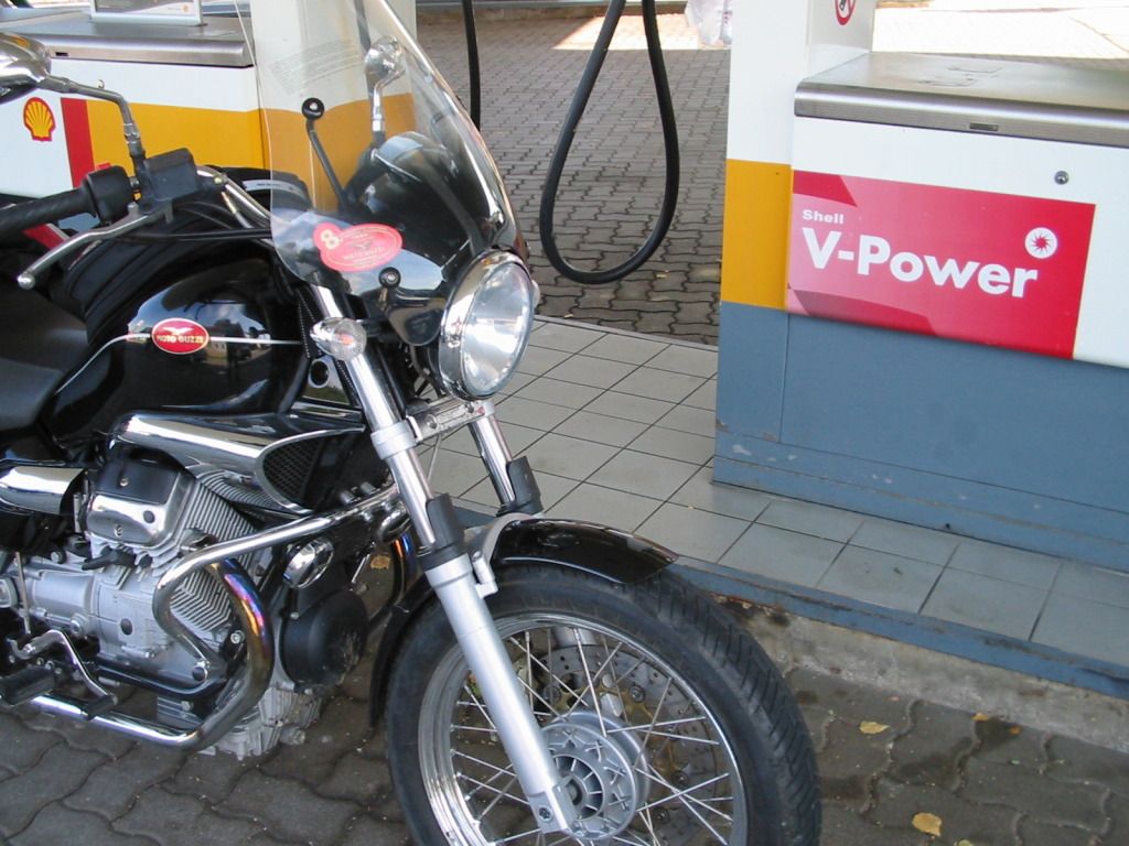

Can you post a pic of the headers? A very slight blueing of the headers right at the beginning which turns gold like this fairly quickly is fairly "normal" unfortunately due to lean settings by the factory.
If it looks like this for more than few inches, it's really hot! And that is not good.

Normal. My Nevada's pipes started going blue right after I got it.
