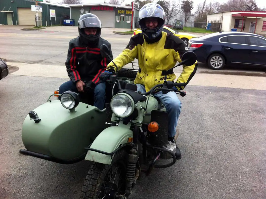

I had an opportunity this weekend to go out to the 2014 URAL Factory Demo Tour here in Houston, Texas and ride me a Ural! :cowboy:
My on the 2014 URAL Gear-up. My insanely trusting instructor David in the sidecar.

I was #17, my wife Andrea #18 and a friend (another Mike, which unfortunately ran out of time to ride) was #19 to ride. (I'm sure Andrea will post a little review of her own as well; so I'll concentrate on my experience below).
The URAL's are surprisingly rugged in construction. You might have seen videos of URAL's going full speed over rivers, across the desert or even through a mountain of mud with a .50 Machine Gun strapped on it... well, let me tell you, that's not CGI but a fact.
As I never rode a sidecar hack before my demo ride consisted of a 25 min training on and off-road with the URAL getting to know it and how it handled with the sidecar some muddy off-roading and then around the neighborhood streets.
